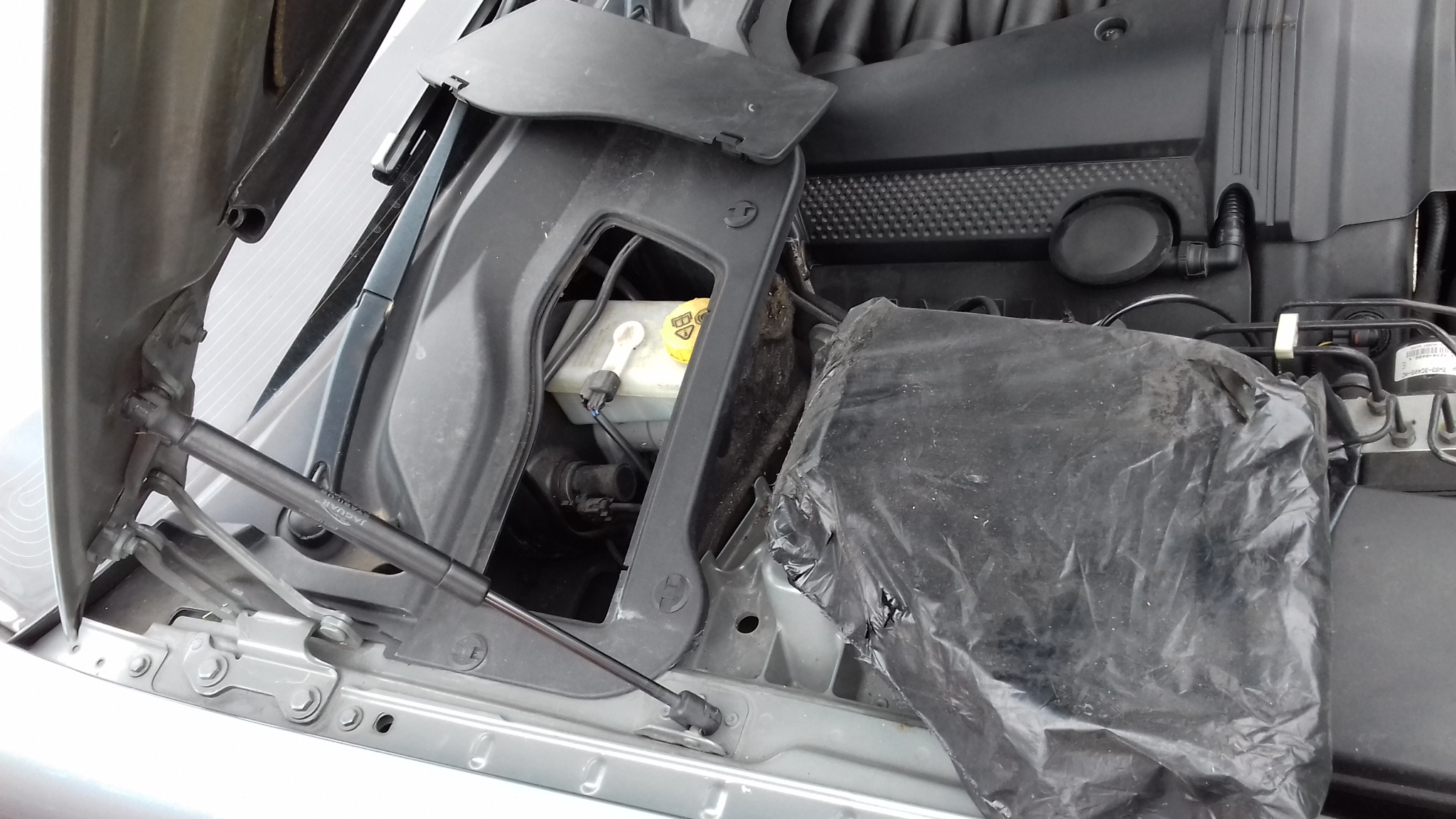

Anyway, I have ripped out as much of the plastic bag as I easily could, and what was inside? Sponge foam! Soaking wet sponge foam! My guess is that this foam filled bag was there either to stop muck getting into the cavity or as soundproofing, and over time it have been holed allowing drain water to get inside.
I’m pleased that this area can now dry out, and I might even try pulling out the foam as well.
BTW, there was a large black foam filled bag in a cavity under the bonnet, driver’s side, that I removed ages ago as it was dislodging the drain pipe in that cavity. Pics attached. Nothing to do this thread maybe, but similar design concept.

The jacking point is just next to the hole, it is on the edge where all the body panels meet and are riveted together. The Jaguar supplied jack is shaped to fit over this edge.
My guess is the bags are just cavity fillers, to keep dirt out, but did more harm than good and were not fitted on later models. I don't like the idea of a wet sponge in my car, so I'm going to pull as much of it out as I can.
I wouldn't use expanding form. If water did get in, it would never dry out! A grommet would be an idea, there are a couple of smaller holes in that area that would allow drainage and ventilation, if needed.
