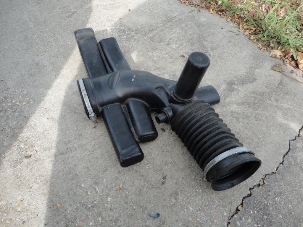

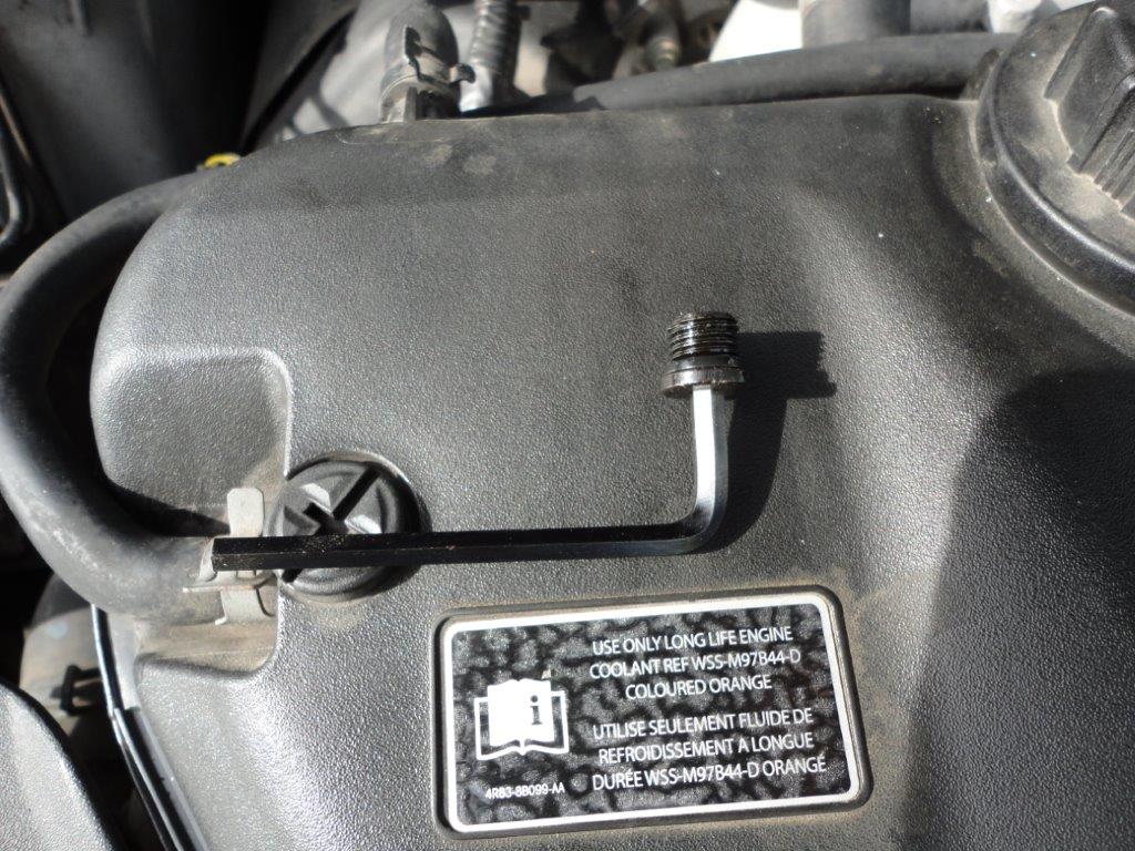

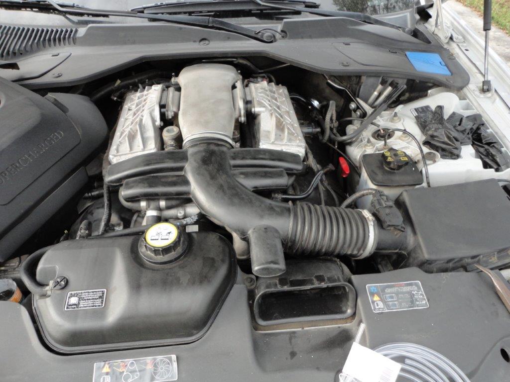

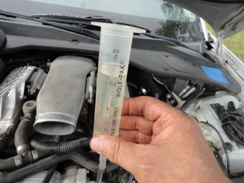

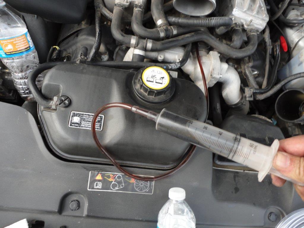

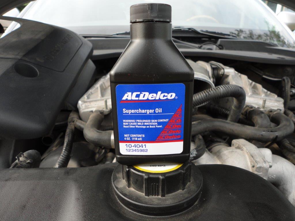

I also changed my supercharger oil over the holidays. Thanks to Mike Baker I knew the drain plug was 3/16 inch rather than metric, but I found it too fiddly trying to use an L-shaped Allen wrench. Instead, I used a 3/16 in. Allen bit in a 1/4 in. socket with a swivel joint and long extension. A magnetic bit or socket would have been handy but I don't have them in these sizes, so I fixed the bit in the socket with electrician's tape so it wouldn't fall out:
I worked the extension below the coolant hoses until I could fit the bit into the drain plug. With a 1/4 inch ratchet I could apply all the torque necessary to break the drain plug loose, and the unrestricted angle of rotation made twisting the plug out a simple matter:
I used a length of rubber vacuum hose from my parts bin with a small I.D. of about 1/16 in. / 1.5mm. I tried to withdraw the old fluid using a syringe, but it took a lot of pressure to pull the fluid through the small hose, so like Highhorse I used my Mityvac hand vacuum pump:
The small I.D. of the hose also made the flow of new fluid very slow, so I used the syringe to force it into the supercharger:
And of course, when trying to reinstall the drain plug for the first time, I dropped it. A magnetic retriever saved the day:
