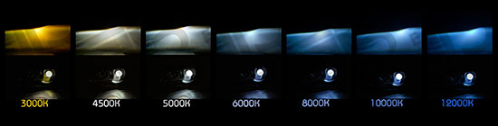

I wonder what brightness the factory bulbs were? 5,000 maybe?
According to the Dealer Training Manual for the 2004 New Model Introduction, the HID headlamps have a color temperature of 4100K.

OSRAM 4300K OEM D1S HID Xenon Bulb Xenarc Germany DOT 35W 66144
The bulbs I replaced were the above.I doubt they were original as I bought the car with 99,000 on it. However I replaced with 6000K HID DS1 bulbs.
Old 02-09-2015, 09:23 AM
jackra_1's Avatar
Join Date: Aug 2014
Posts: 6,264
Received 1,756 Likes on 1,327 Posts
I should add that the new bulbs make my full beam lights look "dull" now and I am hoping to get new hi beam bulbs installed today.
Old 02-09-2015, 09:37 AM
jackra_1's Avatar
Join Date: Aug 2014
Posts: 6,264
Default http://imgs.inkfrog.com/pix/elitemailers/BULBCOLORCHART-Resized.jpg
http://imgs.inkfrog.com/pix/elitemai...RT-Resized.jpg
Have a look at the above link.
