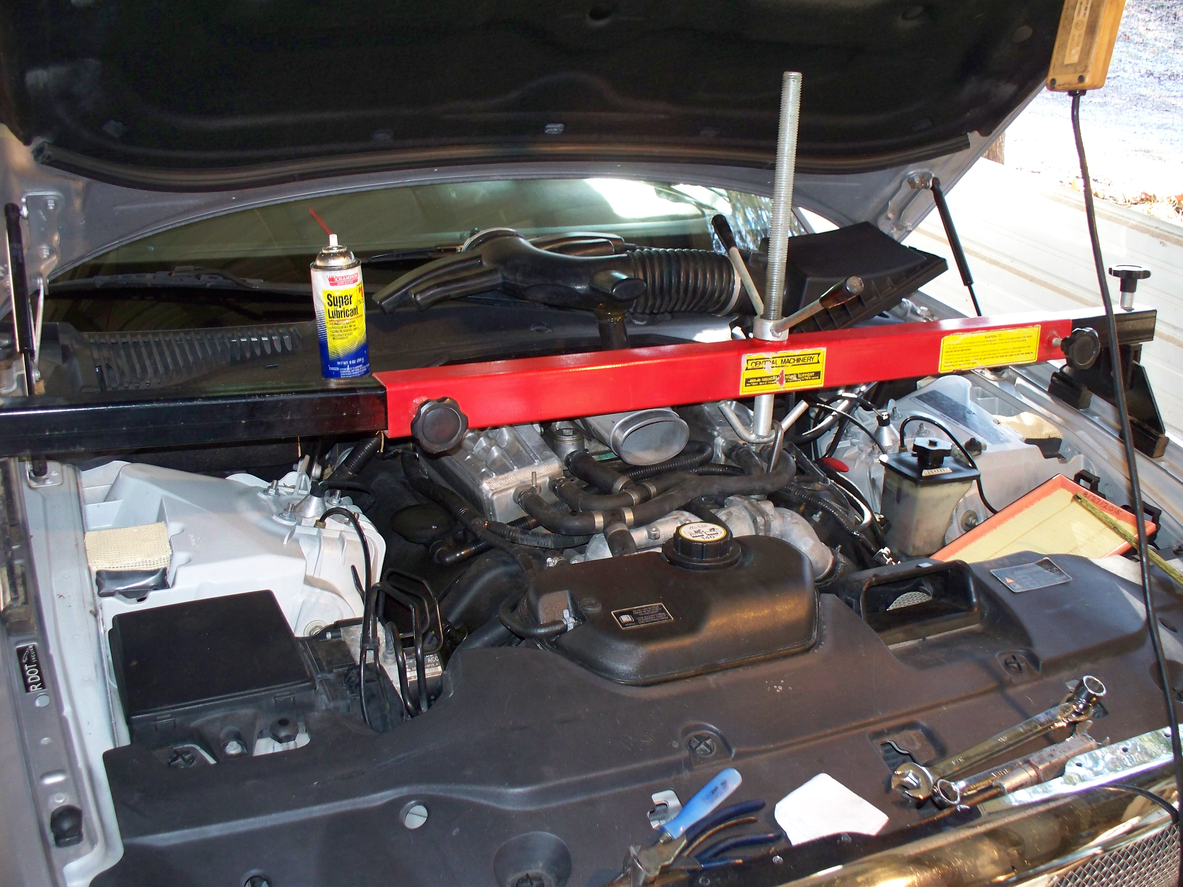

Old 05-09-2017, 05:30 AM
NDW's Avatar
NDW
NDW is offline
Join Date: Jul 2012
Location: Mineola, TX
Posts: 289
Received 76 Likes on 60 Posts
I lifted my engine using small lengths of chain on each side with bolts securing them to the engine as I didn't have access to the brackets you are referring to. They worked just fine.

Old 05-09-2017, 11:12 AM
Wingrider's Avatar
Join Date: Sep 2016
Location: Stow Ohio
Posts: 3,271
Received 798 Likes on 670 Posts
Harbor sold me a beam with a thousand pound capacity, for $60.05 out the door yesterday with a 20% coupon. The brackets shown, are way too pricey from the dealer for me.Will have to think, or make something up, or maybe something is already on hand to use.

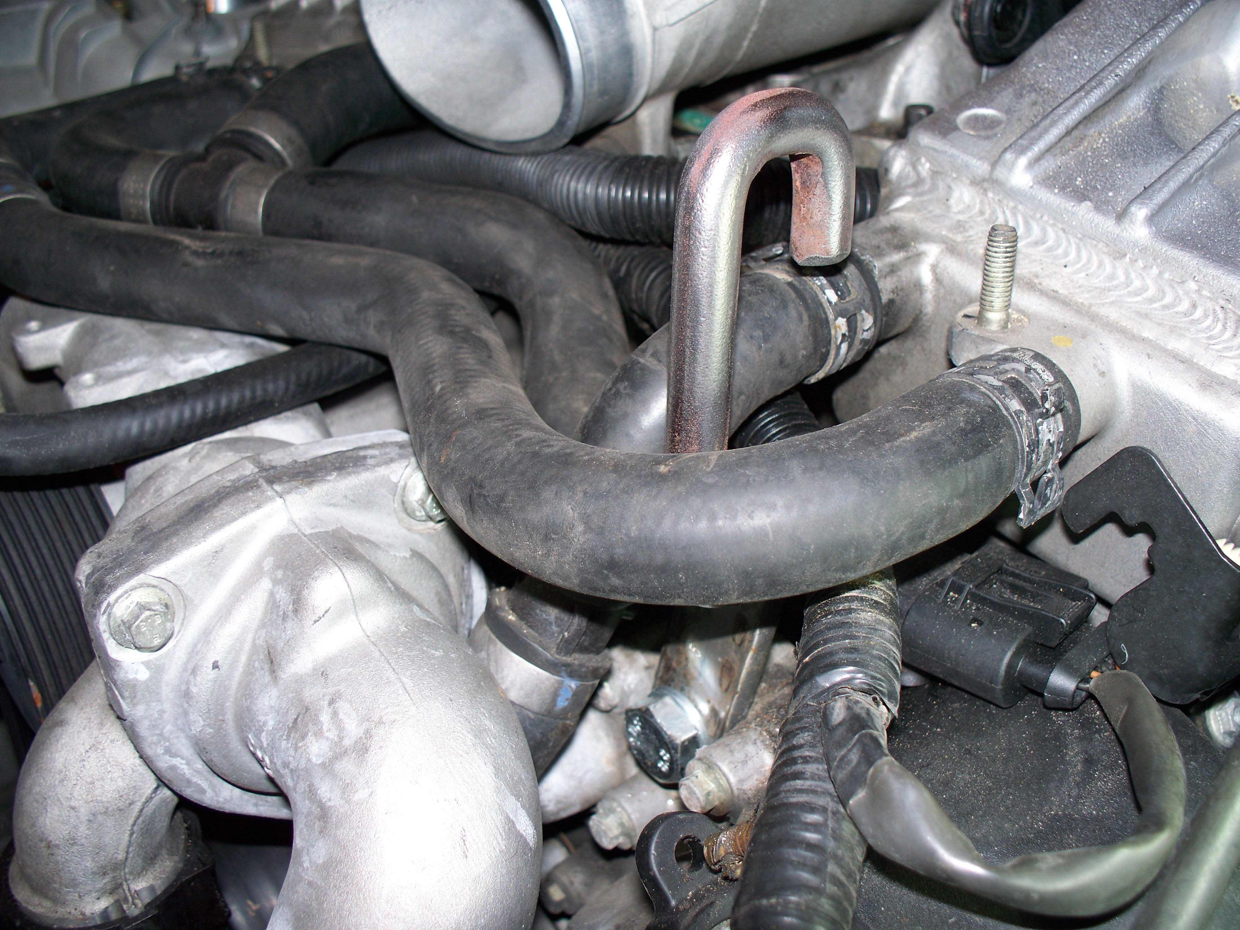

I made my own brackets from things I had lying around and used a lifting beam I already had too. The flat stock brackets remain in place on each side of the engine and the hook (made from an old U bolt) is removable.
It worked well enough for both engine mounts, one at a time.
BTW, does anyone else think that one of the factory lifting brackets resembles that painting "The Scream"?
Not bad at all. What size bolts did it take?
I'm liking all the ideas guys keep em coming.
Had to look back through my notes. They said M12X1.75.
The U bolt hook is 1/2" diameter.
