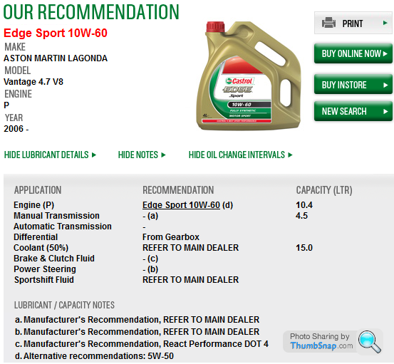

Aston Martin Vantage 4.3/4.7 AJ-engine is not far from our engines.
Also 10W-60 is recommended for BMW M3 and M5 etc.
Attached Thumbnails Engine oil 4..2 l s/c, need suggestions-aston_oil.png

Castrol doesn't design, manufacture or warranty the engines when it all goes wrong, Jaguar does.
OEM's spec always trumps the supplier's.
