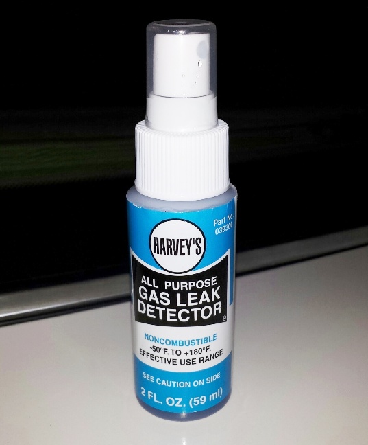

Try a quick check on your air shocks:
Spray a soapy solution on the air-line-to-fitting on top of the shocks (if possible, use a Gas Leak Detector, a lot safer for components).
If air bubbles are present, that is your problem and you will have to tighten the fitting or replace the O-ring between the two fittings.
