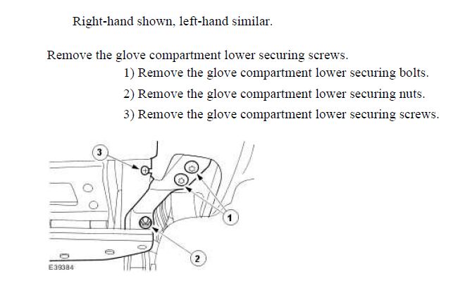

I just had to replace my Fan Control Module and it requires removing the Glove Box. I have seen other threads where removing the Glove Box has been a problem. You will need a #2 Phillips head screw driver (stubby), a T30 TORX driver, and an 8mm scoket or wrench.
Here are the Shop Manual instructions:
NOTE: THE INSTRUCTIONS ASSUME THAT YOU WANT TO REMOVE THE GLOVE BOX FROM THE CAR. THE GLOVE BOX WILL SIT ON THE FLOOR WITHOUT UNPLUGGING ANYTHING!
NOTE: THERE IS A SMALL SCREW BY THE BOLTS UNDER THE GLOVE BOX. YOU WILL SEE IT IN THE PICTURES. IT IS ON THE CENTER CONSOLE SIDE. IT WILL DRIVE YOU NUTS IF YOU DIDN'T KNOW THAT IT IS THERE!
NOTE: THE SCRIVETS HAVE A SMALLER CENTER BUTTON. PULL IT OUTWARD AND THE SCRIVET WILL THEN PULL OUT.
Attached Thumbnails Glove box removal x350 models-glove-box-1.jpg   Glove box removal x350 models-glove-box-2.jpg   Glove box removal x350 models-glove-box-3.jpg   Glove box removal x350 models-glove-box-4.jpg   Glove box removal x350 models-glove-box-5.jpg
Glove box removal x350 models-glove-box-6.jpg   Glove box removal x350 models-glove-box-7.jpg
