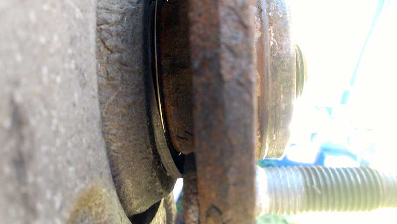

Lightbulb
Well well well... it seems that a metal retainer and a rubber gasket that goes behind it came apart from the HUB SIDE of the bearing and not from the axle (inner) part... This is very strange.
Anyone ever had such a failure before?

Old 07-25-2012, 03:32 PM
Fraser Mitchell's Avatar
Join Date: Dec 2009
Location: Crewe, England
Posts: 9,404
Received 2,450 Likes on 1,948 Posts
Can you show some more pics once you've dissembled it.

Old 07-26-2012, 04:07 AM
Join Date: Dec 2009
Posts: 9,404
I am beginning to think that maybe something off the road got in there and did some wrecking ! This is normally a very reliable component.
