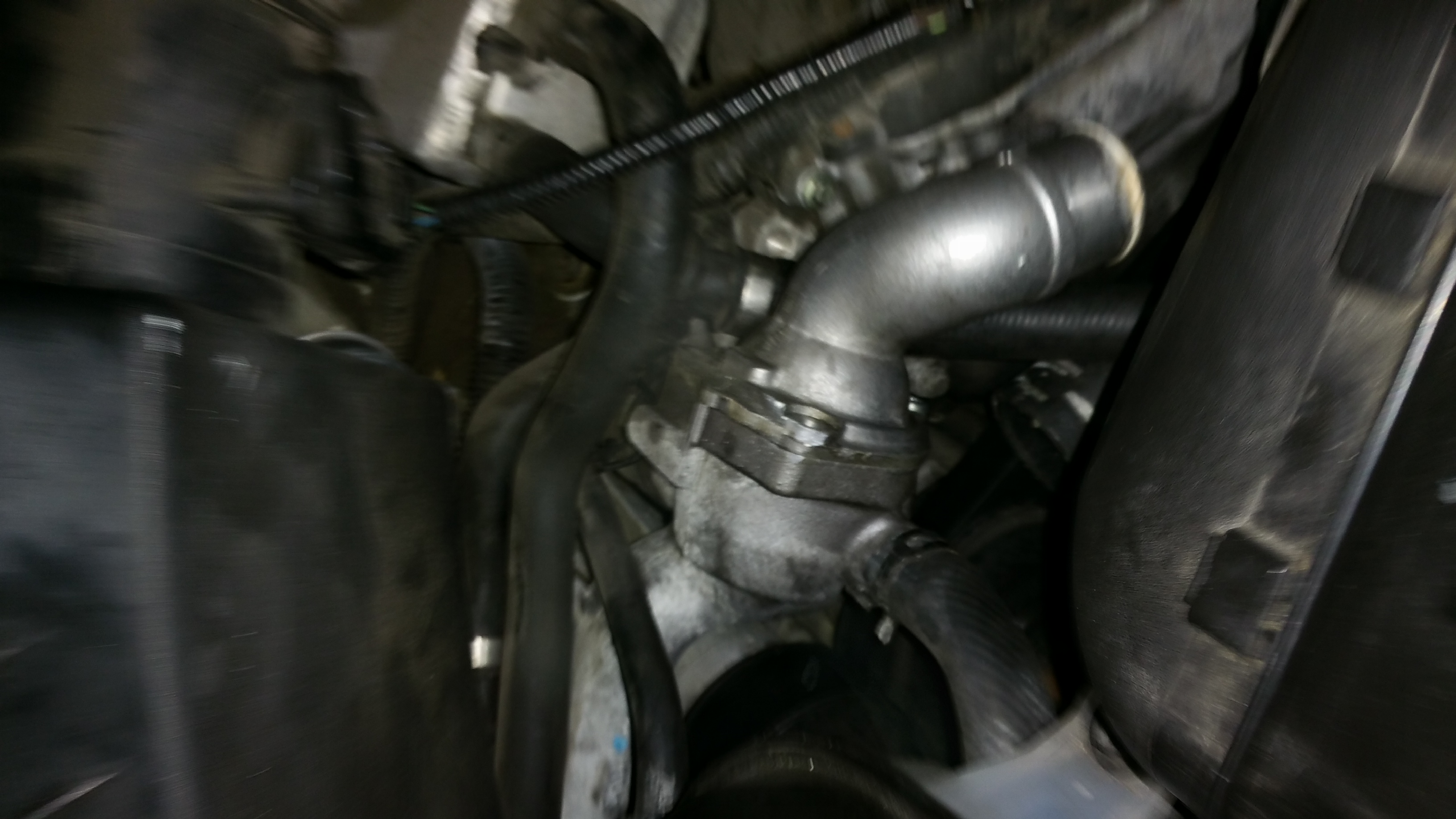

I give up. I'm stumped. I need to replace the thermostat and I can't get the right angle on the bottom of the three torx screws on the thermostat housing that holds the thermostat. Please see the attached photos. The screw is visible on the bottom of the housing.
As you can see, I've detached the upper radiator hose from the housing, as well as taken off the air inlet tubing that leads from the air filter to the intake manifold. I have several ujoints and extensions I've tried in different combinations to try to get a good angle around the convoluted aluminum housing.
I have read that some folks get at this screw from underneath. That seems even more daunting. HELP! Thanks in advance.

Torx? I have normal bolts in there. (X308 though)
Access is not a problem using a 1/4 drive ratchet and socket or bit.
It would be a problem though if using a straight tool such as a nut driver.

Hi Plums. I've read that others have normal bolts in there, some older than mine, some newer. on my X350 XJR, the housing shape prevents unobstructed access to the bottom screw/bolt. The other two of the three screws are easy and are already out. I am patient. I spent over 2 hours trying to get an angle that would allow me to get leverage on that screw. When I get the torx fitting in the screw, the angle required gives me inadequate leverage to loosen it. I finally gave up.
I've tried a straight nut driver, a ratchet tool, ,and then a myriad of combinations with ujoints, extensions short and long,, etc. I even tried a 3 ujoint, 2 extension approach at one point.

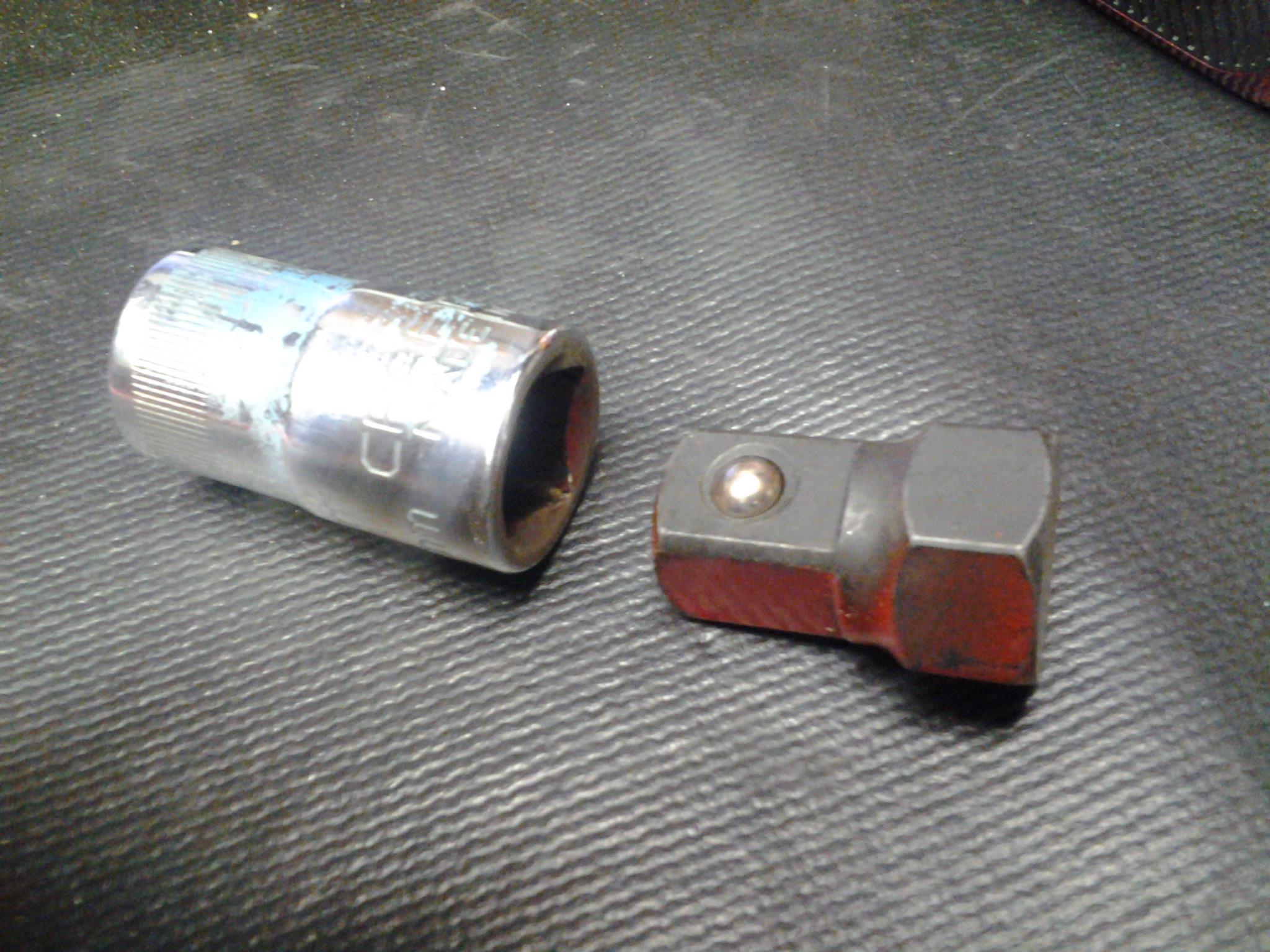

Sometimes you just have to use what you got and the more you got the better it is. Working on one of my other cars I needed something skinnier that a ratchet so I had to make this up and it worked. I used this set up and a box wrench to remove the bolt.
