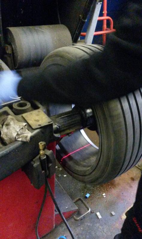

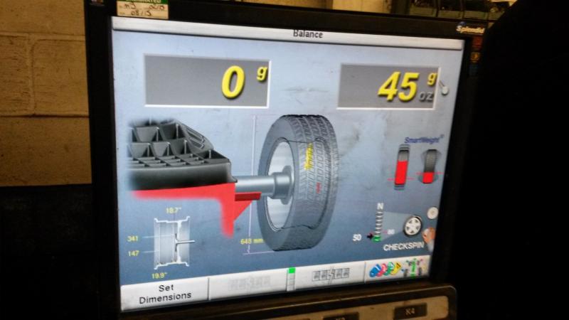

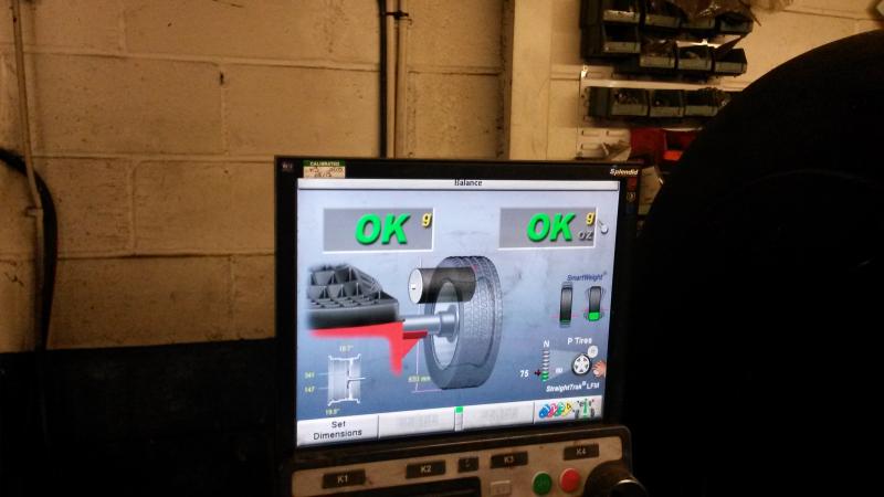

Kieran began by initially balancing all 4 wheels * properly* not the standard balancing for sure.
The machine was fantastic and showed wheel run out ( I have 2 rims that are out of true ) and even high spots on what are new tyres. The Hunter GSP9700 even has a pressure testing system and shows exactly what the tyre is at, along with a laser guide to show precisely where any weights need to be added to counteract any forces.
