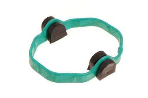

is this the proper hose from egr. Rockauto URO AJ89554?i

Originally Posted by Wingrider
If the manifold is off, those eight pesky little rubber gaskets, inside the manifold, would be a good idea to replace.
What do the gaskets look like and where can i get them?
Thanks,
Tom
Old 01-20-2018, 10:15 AM
Wingrider's Avatar
Join Date: Sep 2016
Location: Stow Ohio
Posts: 3,271
Received 798 Likes on 670 Posts
Smile
Coventry West; Is where i got mine, $134.92 for the two metal, and eight rubber, or silicon gaskets, delivered to my door. Salesman there knew exactly what i was talking about. The dealer has a new manifold available, but knows nothing about any internal gaskets.Thought since Ford has the same gaskets inside their Thunder bird, as well as the Lincoln L S, they would have them, but no such luck.Keep your eyes open, ask questions, pay attention, take your time, and you can almost afford to drive an unbelievable automobile, you will enjoy every time you drive it
Old 01-20-2018, 10:31 AM
talashek's Avatar
Join Date: Mar 2012
Location: barrington il
Posts: 59
Received 3 Likes on 3 Posts
are these the gaskets you are referring too? I got them on ebay from a co. in Austin Tx. $86
Old 01-20-2018, 02:59 PM
Wingrider's Avatar
Join Date: Sep 2016
Location: Stow Ohio
Posts: 3,271
Those are the ones.
