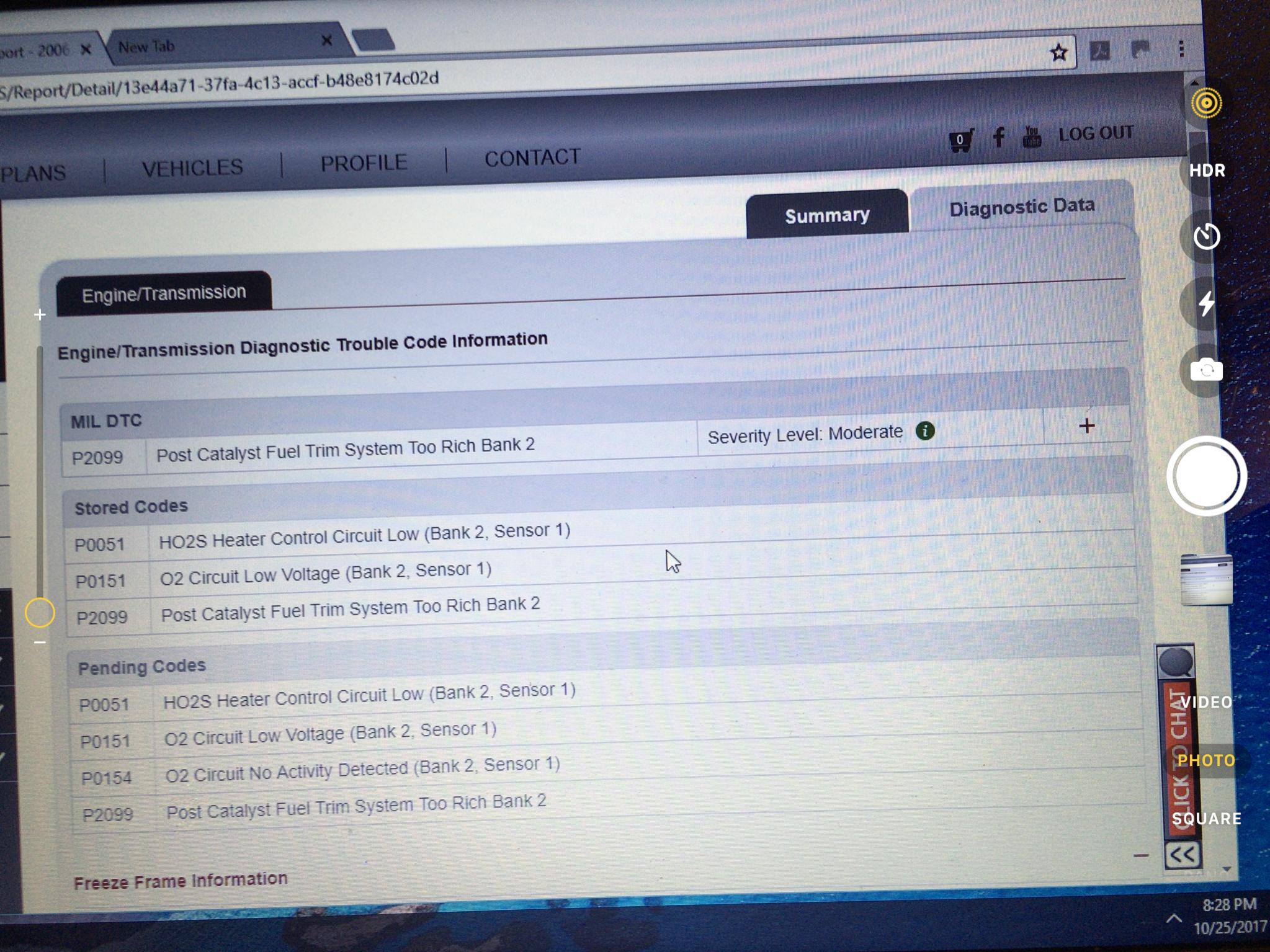

OK, I got the 2006 XJL Super 8 Portfollio today and did all the DMV stuff and there is ‘really’ only one thing wrong with it... <grin>
Check Engine Light is ON - I went to AutoZone to have the codes read, in which, I included the codes below...Any ideas on how I should proceeded to fix this????
There are, I think, minor things i read about in lots and lots of reviews on this car like:
1) Engine or exhaust is a bit loud when accelerating while driving, but sounds cools, like the older muscle car I grow up with in the early 70’s.
2) And more than normal road noise while driving around - Maybe because the the 20” rims. It has brand new Michelin Pilot Sport tires (34 psi front and 36 psi rear)?
3) Auto Streering Wheel/Seat control freaks out sometimes - Sometimes works, sometimes doesn’t work and when off, it sometimes does the auto thing???
I been driving this car around all day today and I just love this car !!!

Looks like an O2 sensor problem on bank 2. Possibly a leak in the intake system as well.
If it is loud accelerating, like a muscle car, then is the exhaust stock, modified, or even damaged somewhere.
The stock exhaust is very quiet on these cars.

So, maybe changing out the O2 sensor on bank 2 might reduces some of these codes? How do I reset the codes, disconnect the battery?
While the car is in Nutural and I give it gas, it’s very very quite, but give it gas while driving, the engine is a bit louder. It’s not bad sounding, but it’s louder than I thought a car in this class would sound.

Congrats on the buy. You got a rare, exceptional exclusive car. The paint is to die for. Hope you keep up the detailing of your beauty.
Most likely you have a vacuum leak. A smoke down test should isolate it if there is a leak.
The electrical DTCs are likely from a bad battery.
In any case, an experienced Jag mechanic can resolve these issues. One question. Why did you buy it with the engine lite/DTC issue without the Dealer fixing it? He knew about it and just cleared the codes before you test drove it. Get him to fix all that stuff.
Good Luck from an 06 SV8 Owner....
Some people swap sensors from right to left and see if the fault transfers over just to make sure it is the O2 sensor(s).
If the fault does not transfer then it is something else like a leak.
I good ODB ll reader will clear these codes once the fault is cleared.
+1 on this. O2 sensors are reading a problem somewhere else and are not typically the problem itself. Swapping them is a quick and free way to confirm they're operating as they should. If the code changes bank, you have a defective sensor, if not, you likely have leak and a smoke test is warranted.
Clearing codes is a whole thing and requires tools. If you are DIY on the shade tree mechanic side, opt for a Foxwell 510 unit. If you nothing about cars other than changing spark plugs, oil and air filters and tires, find a good independent mechanic, preferably who specializes in Jaguars.

Jackra_1, Thanks for that link, very cool!!! I looked up the P2099 code and it says the most common cause is the ‘mass airflow sensor. Other causes are:
1)mass airflow sensor’s circuitry
2)air inlet tubing connect to intake manifold could have vacuum leak
3)02 sensor
4)fruity fuel pressure regulator
5)manifold absolute sensor
6)powertrain control module
And if the engine don’t show symptoms and runs good, it’s most likely the 02 sensor.
OK, My XJ engine sounds really good, with no perforance or shaking issues, misfiring or any issue, the car runs really well....Do you know a link that shows me where the mass airflow sensor is and all the other causes - sensors/modules/regulars are? If it’s easy to swap out the two 02 sensors, that’s what I will do first!!! I guess, I’m still trying to avoid taking my car to the Jaguar Dealer. <grin>

If you look at the air filter housing and follow the inlet pipe to the left you will see an electrical connector attached to the MAF sensor going in to the pipe from the rear.
If the issue is not the O2 sensor I am leaning strongly towards a leak somewhere.
However, having said that, a leak in a "common" part of the inlet would cause problems on both banks I would think.
I had a problem after I installed new O2 sensors, all 4, and it turned out that I had not torqued one of the sensors in snugly enough. So my code fault was on that side only just as yours is.
You need to fix this as too rich a fuel mixture could harm the catalytic converter over a period of time.

I'm still with Jack. Swap the 02 sensors first and see if the codes change but yes it could be a bad sensor and it looks like you have a intake leak.
P0051 - 02 sensor circuit failure.
P0151 - HO2S sensing circuit - short to ground, short to power, high resistance.
P2099 - Check integrity and correct installation of air intake system.
likely and air intake leak - smoke test lots of video on how on YouTube.
