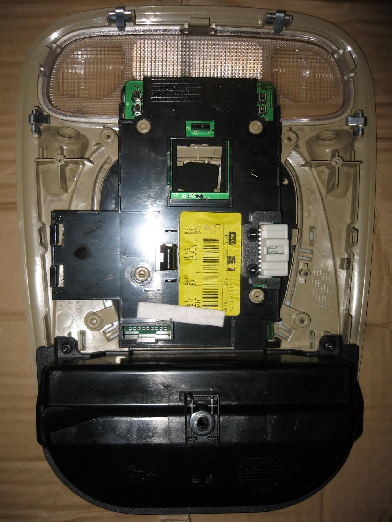

I want to attempt this tomorrow could you elaborate a bit more? What did you do to drill out the surface weld? How big a drill etc.
I really don't want to bugger this up.
Is it the blue square or red square welds I have marked on the photos below to drill out? What sort of computer self taping screws did you use?
Attached Thumbnails Mic not working-img_4545.jpg   Mic not working-img_4545a.jpg
Old 05-01-2014, 04:26 AM
alecescolme's Avatar
Join Date: Jan 2014
Location: England
Posts: 433
Received 134 Likes on 82 Posts
To remove the welds, take a large diameter drill bit, say 12mm and turn it by hand, so that the blob on the surface is removed and use a sharp craft knife to make it flush with the surrounding material. With luck you should have broken the weld, may not do immediately, just keep taking small amounts off.
To completely change the bezel colour, you will need to do both the circled blue and red welds.
The screws are just some old one I had, they need to be just enough to bite the hole down the center of the spigot and have a large head, or use a washer.
