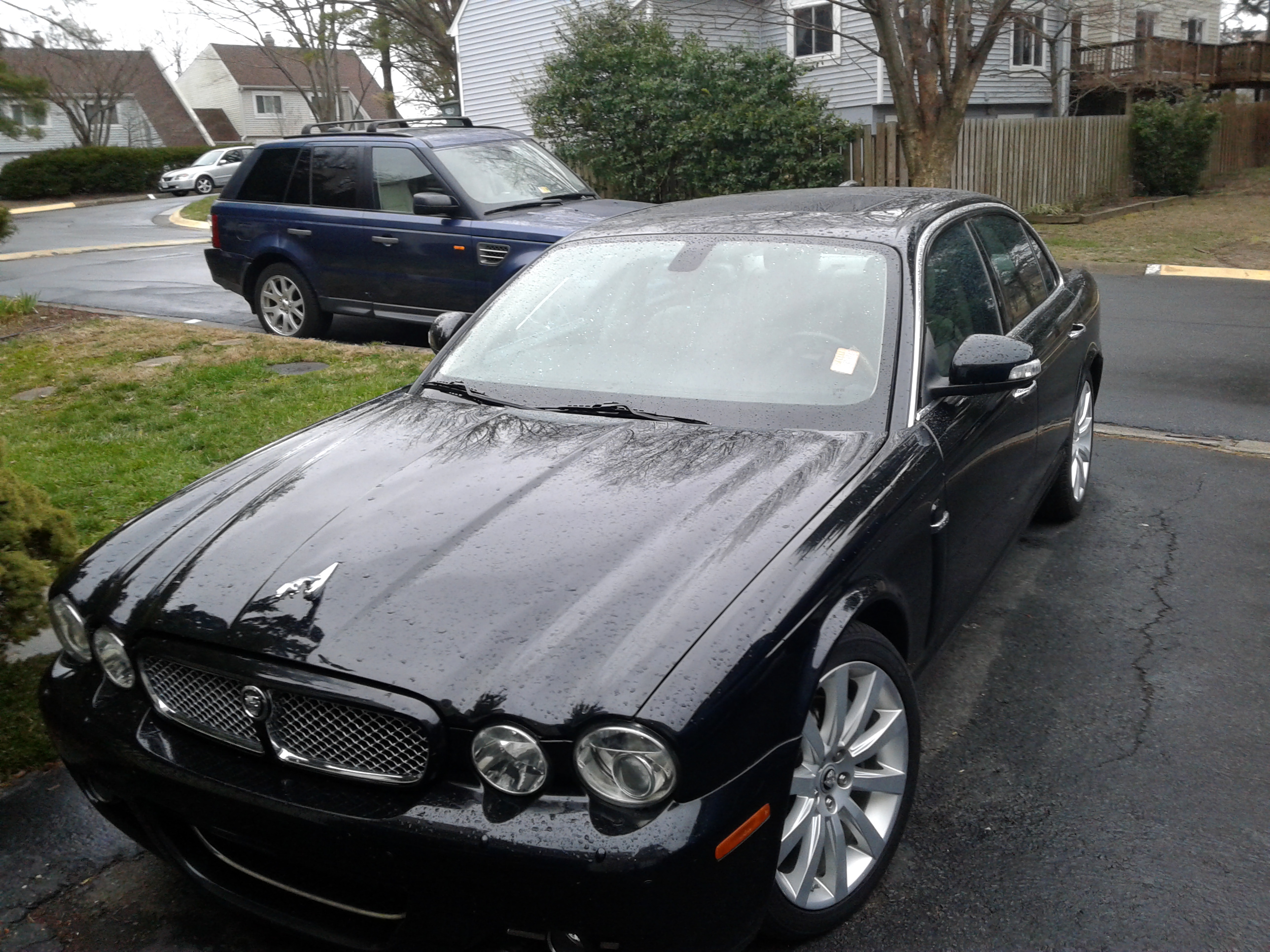

Hi guys, I just picked up a 2009 XJ for my son's first car. It's a beauty. We've only had it a couple of days, but one thing seems not quite right. It seems to
be a bit bouncy going over speed bumps, and especially the right rear. There are no error messages. It's as if the shocks don't rebound quick enough ? We
have a Range Rover Sport with air suspension and it feels solid, the Jag feels a little Jello-y. The compressor seems to be working fine. Anybody had a
similar experience ? TIA.

The fact that one side seems bouncy compared to the other could indicate that one of the rear suspension units has been replaced but the other hasn't; indeed even possibly that the replacement only has a single setting damper (with a resistor to fool the suspension module) rather than one with a proper two-state (CATS) damper.
It would be worth having a look.
