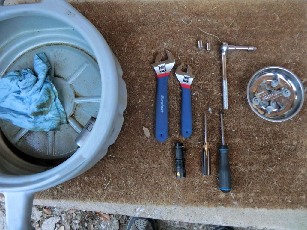

I used the following tools,
2 x adjustable spanners.
2 x Posi drive screwdrivers.
1 x magnetic based bowl.
1 x flashlight
3/8 inch socket set. 2" extension, 10mm socket.
Blue workshop paper.
Oil/fuel catcher

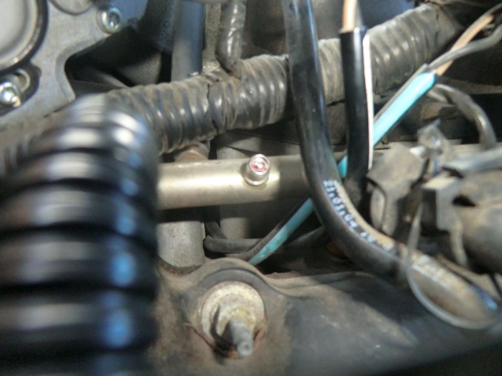

4. Identify the Fuel rail pressure release valve and remove the blue cover to show the shrader valve.
5. Using the workshop paper , use a small object to press in the schrader valve and fuel will be released. Catch it in the paper. Do this multiple times over a couple of minutes.

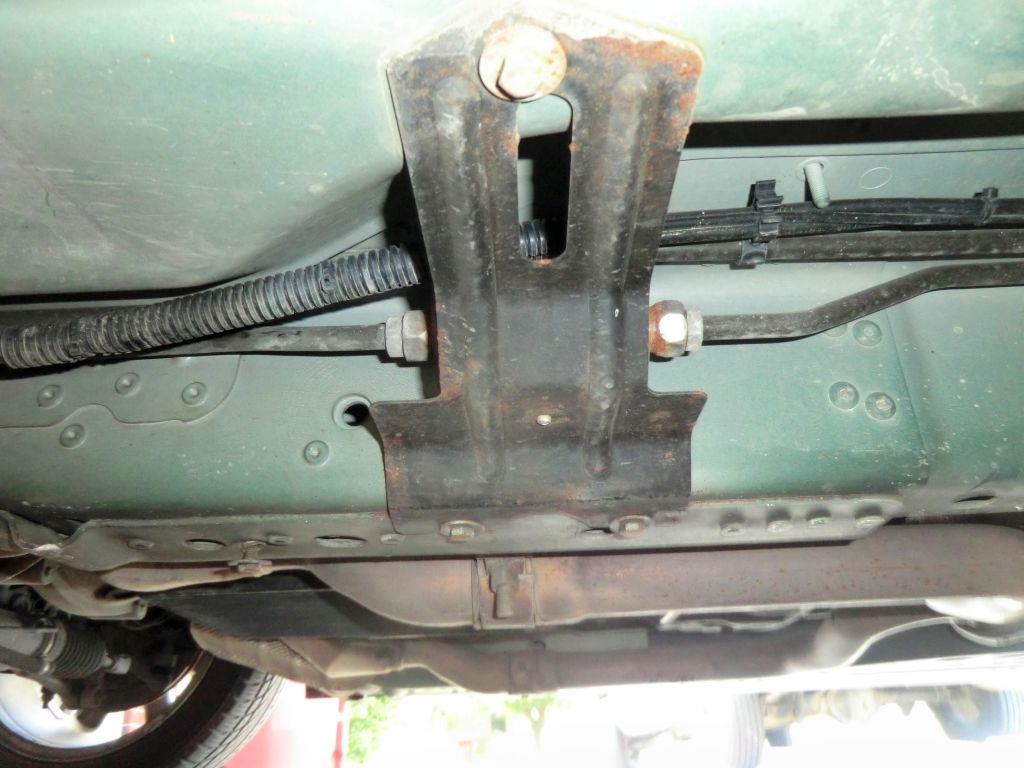

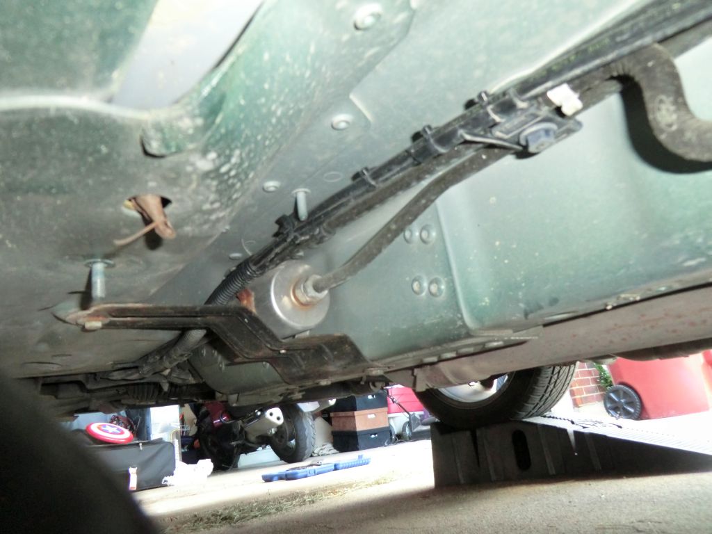

6. Crawl under the vehicle and use the rachet to loosen off all the 10mm bolts holding the cover on. I found that every time i removed a bolt, I released pressure at the schrader valve and still fuel came out.

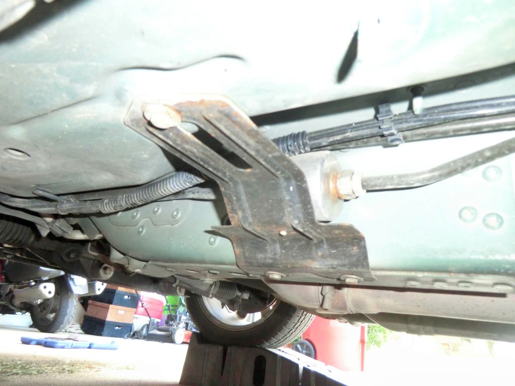

7. Identify the Fuel filter and remove the 3 x 10mm bolts holding it in place. The fuel filter is held in position by a clip on the plate.
8. Unclip the filter.

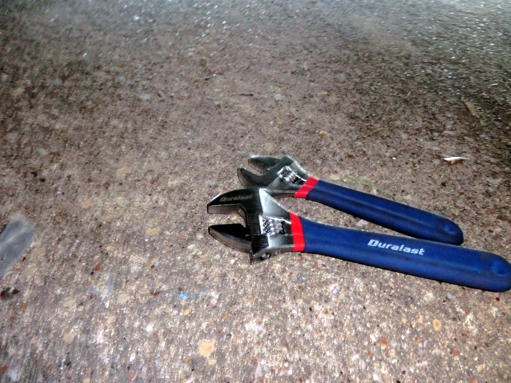

9. I used two adjustable spanners to loosen the nuts holding the filter on.

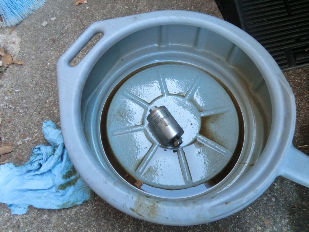

10. On loosening the nuts the filter leaked about 200ml of fuel into the bucket. Once this had drained no further fuel came out. So don't worry.
11. I pushed/pulled the filter to the front of the vehicle and it fell away. I inspected the piping and found it was good. I inspected the nuts and found some slight green discolouration which is expected. There were no O rings.
12. I cleaned up the piping and fitted the new filter. The tape is to show me which was was forward on the filter. I did not add O Rings.
