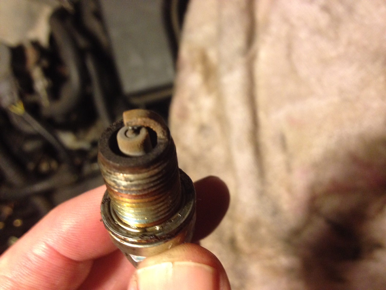

Hello. My wife's 04 XJ8 has been a very reliable car. Today however, when she backed out of a parking space the engine went into restricted performance mode and ran roughly.
When I got home from work I pulled P300, P301, P303, p305, P1313 and p1316 codes.
I took out the number one cylinder coil and plug; the plug looks ok. Going forward with the diagnosis my SOP (standard operating procedure) would be to move coils/plugs around to determine the cause, but with three cylinders that are right next to each other misfiring it seems too coincidental to be plugs or coils.
Could the PCV valve that sits atop those cylinders be causing the problem? There is a light oil residue in that general area (beneath the PCV).

I removed the PCV to inspect it. It does not rattle when shaken, and air goes through freely in both directions. I filled it with carb cleaner several times and drained tons of dirt out, but it still doesn't rattle and air goes through easily in both directions.
I am no expert (understatement), but it seems the valve is shot?
Would this cause a massive vacuum leak in this area possibly accounting for those three cylinders misfiring?

Hi Jeff,
It definitely sounds as though your PCV valve is stuck open, which can cause misfires at idle. The P1313 code indicates that the misfire rate could lead to catalyst damage, and the P1316 code indicates the possibility of excessive emissions. At the link below you can download the full Jaguar X350 DTC Summaries Manual to see the lists of other possible causes of your codes:

The PCV valve won't rattle like the old style ones. If you have oil residue on the cam cover that indicates the o-ring is seeping. They are oddball size metric 2.65 Cross-Section, 2x 16mm and 2x 14 mm ID on the PCV side.
I think the proximity of the PCV valve to the misfiring cylinders is a red herring. The PCV pulls vacuum into the throttle body, so a leak would cause a lean condition on all cylinders (or one bank). I would look closer at the harness feeding the related coil packs, as that might be more relevant to a group of coils not firing.

The last time I started the car (day before yesterday) it ran very rough and began misfiring immediately upon starting the engine. The misfiring was continuous at idle and only seemed to stop at higher rpm.
I bolted on the new PCV valve that was waiting on my front porch. I didn't do a hard reset, I took the lazy way out and just erased the codes with my scanner. The car started easily and ran smooth with no indication of misfiring. I went for a 10 mile drive at varying speeds and pulled it back into the garage, still running smooth with no codes. I plugged in the scanner and only got p1000, which I had expected since I cleared the computer.
I have worked on cars enough to know better than do a victory dance. It certainly "appears" as though the PCV valve was the problem, and that the new one "fixed" the problem. I am also aware of the possibility that I may have moved a wire or somehow inadvertently improved a connection that solved the problem. If my wife drives it for a few days with no recurrence, then and ONLY then will I perhaps accept that the cause of the misfiring was in fact the PCV valve.
