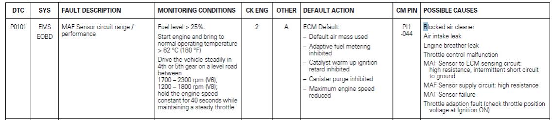

this is what the JTIS says, did you check for air leaks?
