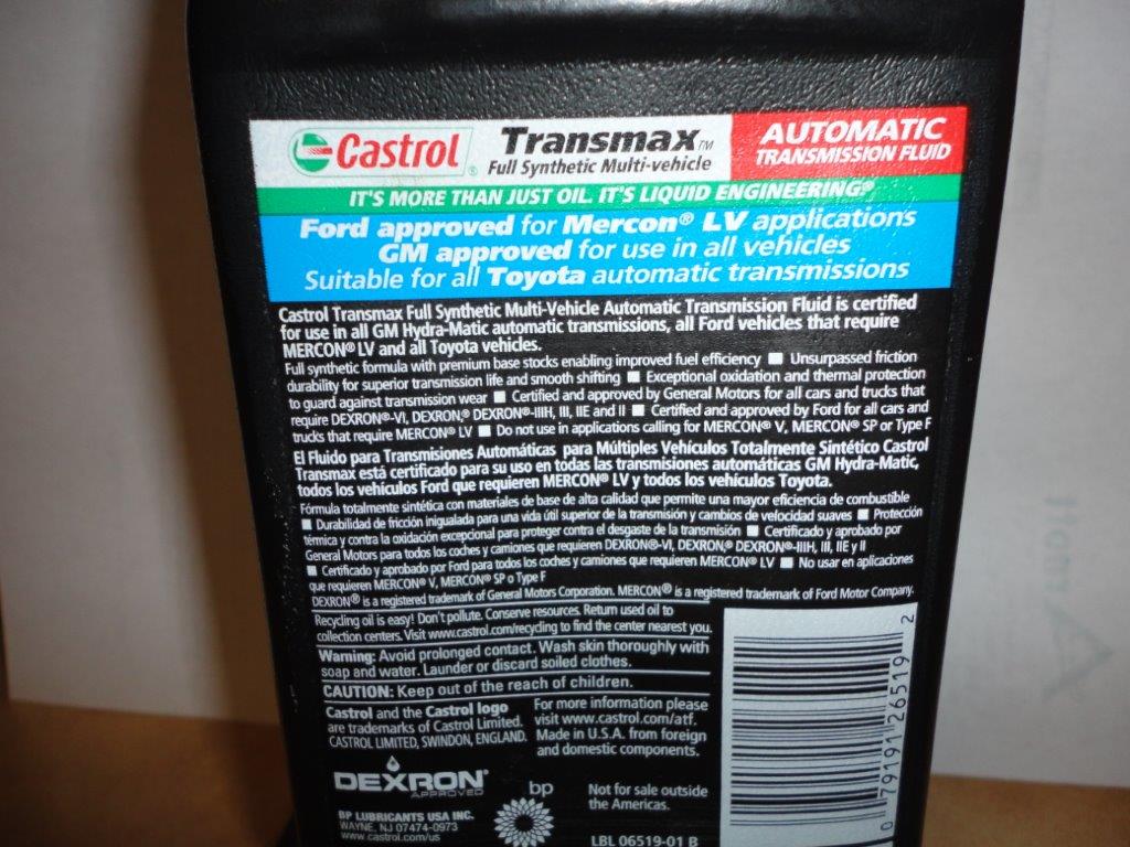

What I was able to find at Autozone was Castrol Transmax, which was a full synthetic and according to the label is approved for vehicles calling for Dextron III.
