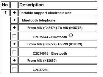

That number will be the manufacturer's ref and not the Jaguar part number. Here's the range from the Parts Manual:
Anything to do with BlueTooth from Jaguar is extremely expensive (think $thousands). The major downside is you can only pair one phone at a time and the compatible phones are limited.
My last XK8 didn't have BlueTooth fitted but my current one does. If it didn't, I'd definitely go aftermarket and not retrofit.
