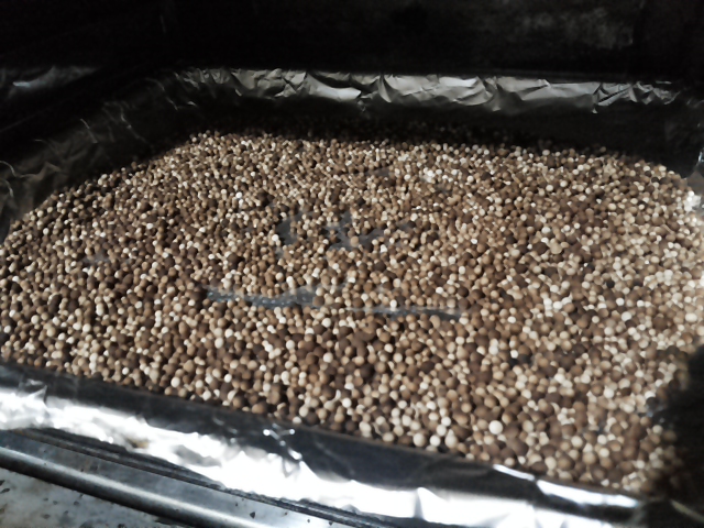

Here are the dried beads in an oven cake pan...
Will be putting all of it together tomorrow.

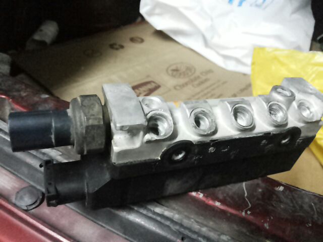

The attached photo.... the valve that was our initial concern. I think in Jaguar acronyms.. it is the Control Module / ASM ?!? Before giving all back to the mech to fix in the vehicle, should we treat this also ?

That is the valve block, and I would recommend that you not do anything to it except to clean the electrical connectors with zero-residue electrical contact cleaner. Take care not to get any debris in the holes for the air hoses.
Jaguar claims that the valve block is a "non-serviceable part," meaning that if it fails, it must be replaced as an assembly.
