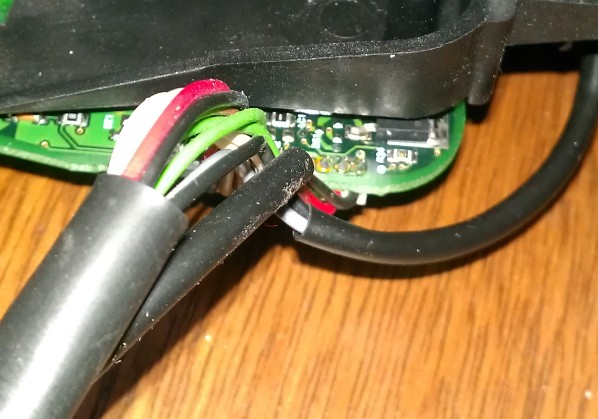

I might have located the problem; a burnt circuit on the J-Gate LED board?
There is a cable running from the J-Gate lock solenoid up under the dash, protected by a gray multi-ribbed rubber covering.
Anyone know what it is for?

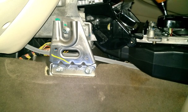

Re-installed all the parts (-one) and went for a test drive----OK so far, no codes or warning lights.

So the solenoid is out now?
The grey cable could be one to prevent removing or turning the ignition key while NOT in Park.
That circuit board did look crispy. Was it a transistor/scr that fried?

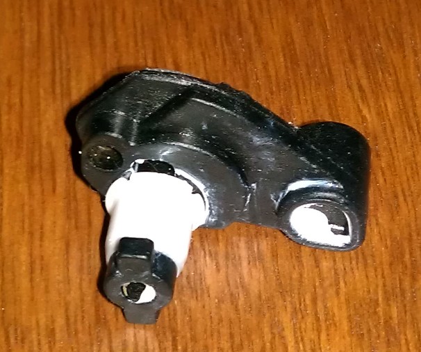

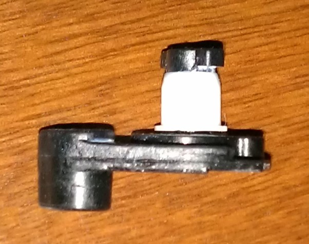

This is the part I removed:
Attached Thumbnails Shift Lever Stuck in Park-shift-lock-bracket-1.jpg   Shift Lever Stuck in Park-shift-lock-bracket-3.jpg   Shift Lever Stuck in Park-shift-lock-bracket-4.jpg
