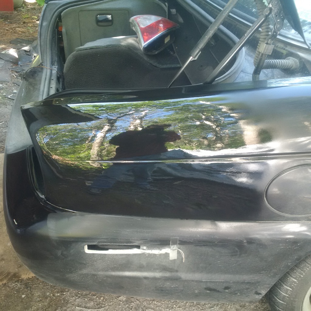

UPDATE:
So, I had some free time last week so I started the repairs. It's not done, but the new piece of quarter is in, primed and a shot some rattle can clear over it just so it doesn't stand out so much (I hate driving around in a car that's not 'all together'). I've still got to get rid of some wobbles and small imperfections due to adding a flange and possibly not getting everything perfectly lined up. However, while it doesn't meet with my approval yet, I've had people look at it and couldn't tell it was damaged (but most people can't tell if their bumpers are missing). Put a new tail light in too. Sill have to sort the rear bumper marker and harness, but overall, I'd say I'm pretty happy with it. You can judge for yourself.
I still think I need to 'massage' that indented body line to make it perfect, but, from more than about 5 feet or so, it looks perfect.

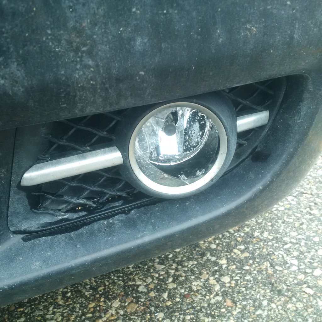

But, all doesn't always go well. Right after fixing this, driving home, a truck passed going the other way, and decided to shower me with stones. The result was a cracked windscreen and this:
Not the worst thing, and I am just about to order new LED fog lights, but still, kinda just makes me 'twitch' a little now!

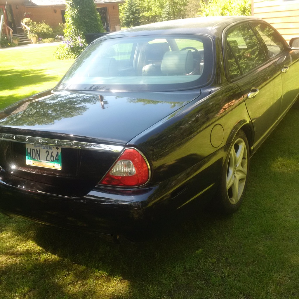

UPDATE: Alright everyone, it's all done! Finished the painting this weekend and all that is left is to cut and polish it to get ride of some orange peel and dust nibs. I still have to put in the side reflector on the right, but that is nothing, just didn't have it with me so I'll pop it in later. So, from time of claim to fixed, 1 month. Find me a shop that can do that on a car like this, and do it right, and I'll give you a free respray! So, here are the pics, what do you all think?
And now all back together with the resprayed boot lid, infill panel, and bumper.
Below is where I put my masking line. I tried to use the curve in the body to hide it. I think I managed to hide it pretty good!
And just trying to show that amazing red that comes out in the sun.
Now, I will do the final cut and polish this week and go in for my re-inspection, then get a nice fat check from my insurance!
