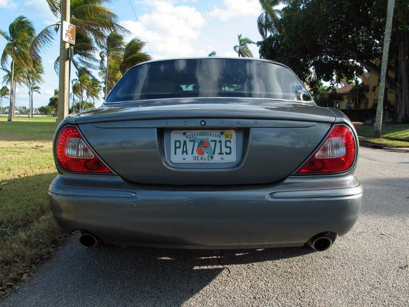

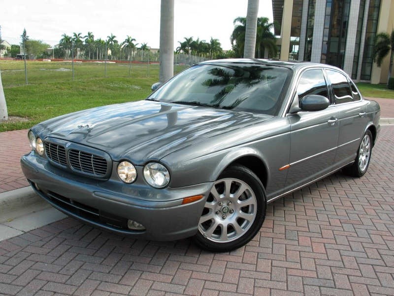

I have a question -- I've noticed that some of the 04's and up have body colored trim around the grill and the trunk piece. Can anyone tell me why? What does that indicate? Was it that way only on certain models (e.g. "base" model) or just certain colors? I've looked online and can't find an answer to this question.
Thanks!
Mike
Thanks!
Mike

I believe the body color pieces you are referring to are found on the XJR models. As far as I remember, the X350 XJ8, VDP, SuperV8 all have the chrome grill surround and trunk finisher.
The XJRs have the body-colored grill surround and trunk finisher.
Thanks-
mag
Thanks-
mag

Oh yes, I believe you are correct in that this was an owner's choice 'customization' and not from factory. Usually, when the grill surround is body color, it is usually a mesh grille and not the grill veins... I wouldnt have considered that without your pic-thanks.
It seems that the previous de-chromed the car on the bumpers, too.
thanks-
mag

![](https://www.jaguarforums.com/forum/attachments/xj-xj6-xj8-xjr-x350-x358-28/34547-thinking-about-upgrading-lg_800.jpg?dateline=1361725796)
![Default](/forum/images/icons/icon1.gif)
Easy and relatively inexpensive to do...
Thanks
Mag
