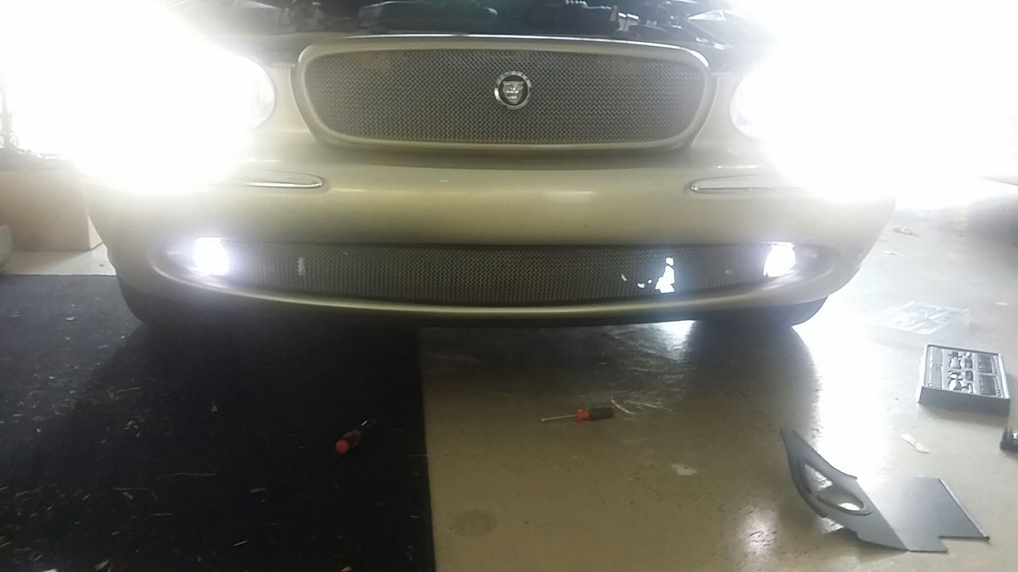

I did a few mods today & 1 this past Monday. The ones today were subtle, but sweet. I just switched the side marker lights to LEDS, & the fog lights to LEDS. Looks good. I hadn't got any night pics yet...
& on this past Monday, I received the Mina Gallery intake thanks to my guy Evan Trinh! I installed it & have been driving on it with a noticeable difference in the sound (not loud or anything, but a different sound that I like) & definitely get up! I had to adjust my take offs from a stand still. I just filled the tank up on yesterday, so I can focus on mpg now... No CEL or anything after install...
Attached Thumbnails What did you do to your X350/X358 today?-20160922_152730.jpg   What did you do to your X350/X358 today?-20160922_152705.jpg   What did you do to your X350/X358 today?-20160922_155734.jpg   What did you do to your X350/X358 today?-20160922_150953.jpg   What did you do to your X350/X358 today?-20160922_152719.jpg
