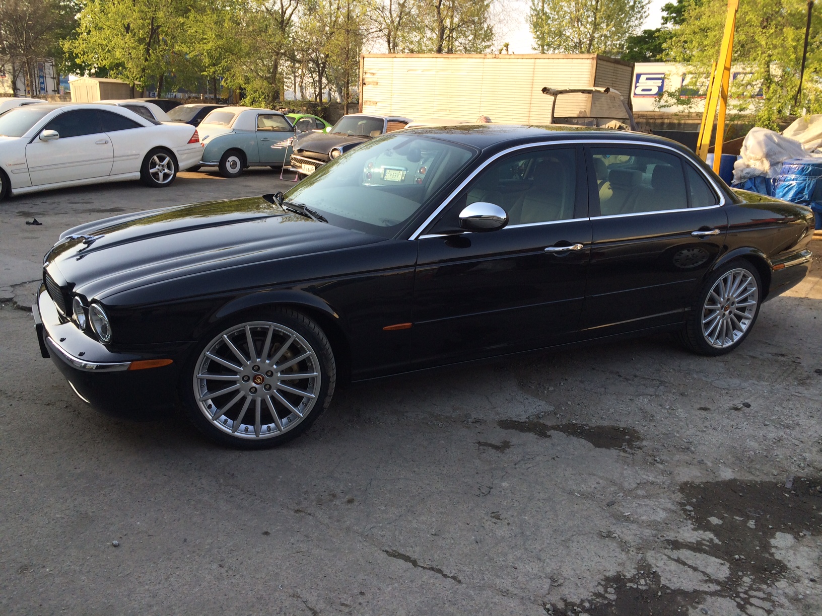

btw, below is my car. Love it, except this speedometer and air suspension..
