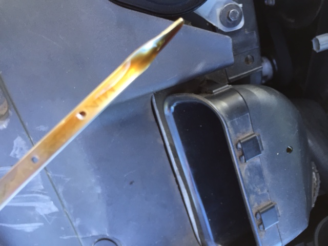

So I took off the radiator hoses and thermostat housing cap and not liking what I see so far.... Pictures attached. The oil on the dipstick looks completely normal but I can see a milky white substance (coolant/oil mix sludge, I assume) in the left side port that leads from radiator to port near thermostat housing)
I don't see any white sludge on the on the big drivers side radiator hose but I do see white milky substance on the port on the passenger side of engine bay that leads to/from the radiator to a port just to the left of the thermostat housing. Also see milky substance in the thermostat housing once I removed the thermostat.
I am thinking maybe the plastic thermostat housing cracked out of no where or perhaps the water pump went out as there was no "low coolant" warning, it just went from normal operating temperature to totally overheating, not a gradual rise in temp then overheating like I experienced when a coolant hose blew out. Also the steam was coming from the thermostat area when I stopped the car and the engine died.
Am I potentially screwed in light of the milky substance in the thermostat and on the passenger side port that the big hose from the radiator connects to?
Any input greatly appreciated

Don't get carried away, Hawaiianjag.
Fix your cooling system, or have it done. Get the fault codes read. Fill it up, leave the cap open. When you start her, look for bubbles in your filler tank. If not, go drive.
When a cooling hose really blows it can go all to quickly.
Not from experience, but I've heard that the kevlar ones, when they go, will split wide open.
If it drives ok, replace all of them hoses, one fails, the others are prone to.

Regarding the water pump, I'd replace with one with metal impeller (aftermarket)

Luckily I have a mechanic that lives on my property so we will be doing all the work here in my garage. Seems like the intake manifold needs to be taken off to remove the thermostat housing. Air escaping from somewhere in that area which I assume is not normal. Going to investigate further. Keep the forums posted on what we find.
If the thermostat housing looks okay and dont see any cracks in it my next guess is the water pump if all the hoses check out okay after we double check them. I don't see what else it could be? If it ain't the hoses or thermostat housing it would have to be water pump right? Not very familiar with this cooling system but I can't think of what other part could leak
