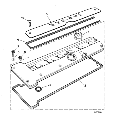

![Default](/forum/images/icons/icon1.gif)
Well done.
That oil in the hole is from the spark plug tube seals, mainly.
Some report the camcover itself "corroding" at the face of those tubes, where the seals sit, but I have not had that with mine.
When I did mine, I used a good smear of Hi-Temp RTV on those plug tube seals, and also at the "D" section of the outer gasket, just to be sure.
![1996 XJ6 rough running when cold, fine when warm-aj16-camcover-parts-drawing.png](https://www.jaguarforums.com/forum/attachments/xj-xj6-xjr6-x300-26/145431d1492074035t-1996-xj6-rough-running-when-cold-fine-when-warm-aj16-camcover-parts-drawing.png)
#3 are the culprits in question.
Chucck, #4 spark plug well seems particularly prone to corrosion and deformation judging from the five I've inspected. You'll find some pics of what is likely going on here: https://www.jaguarforums.com/forum/x...thread-163891/
