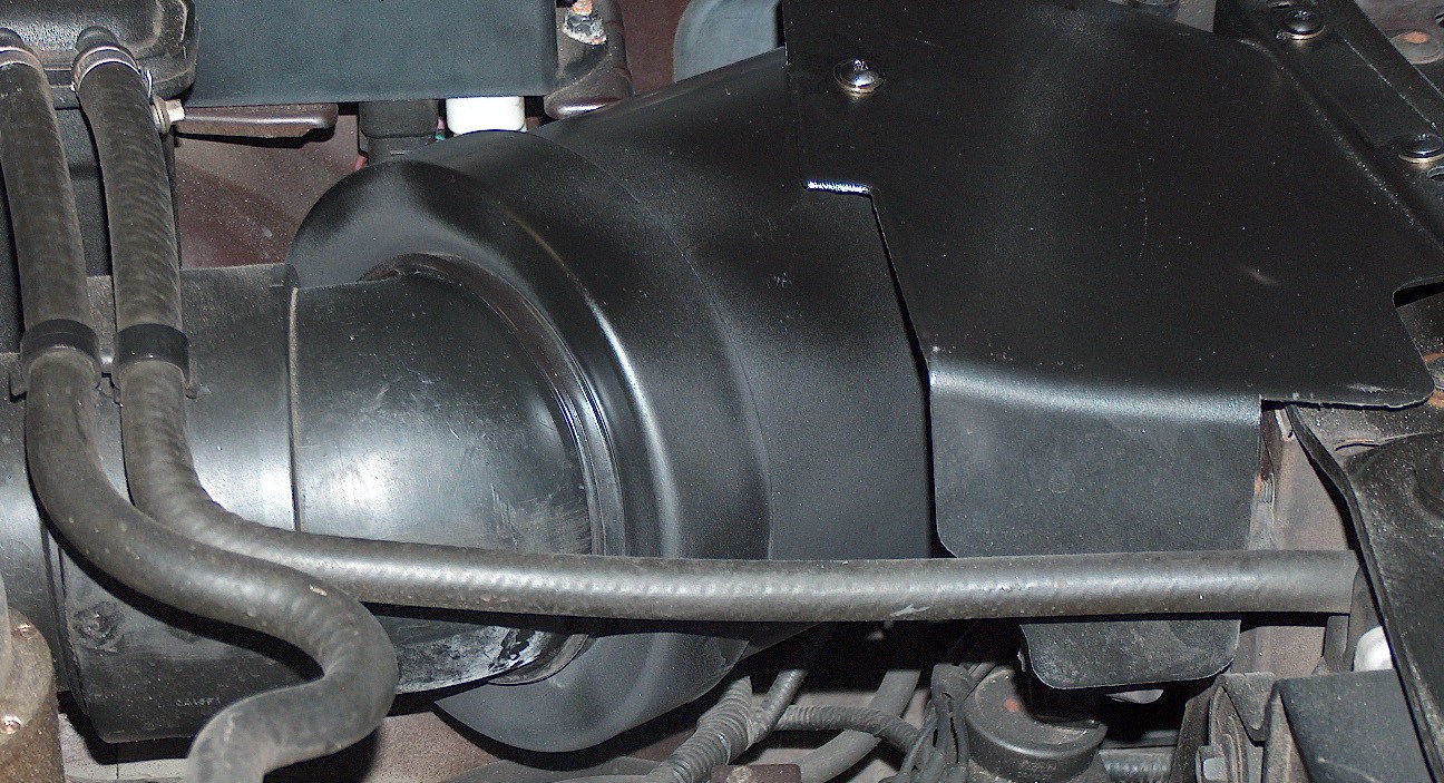

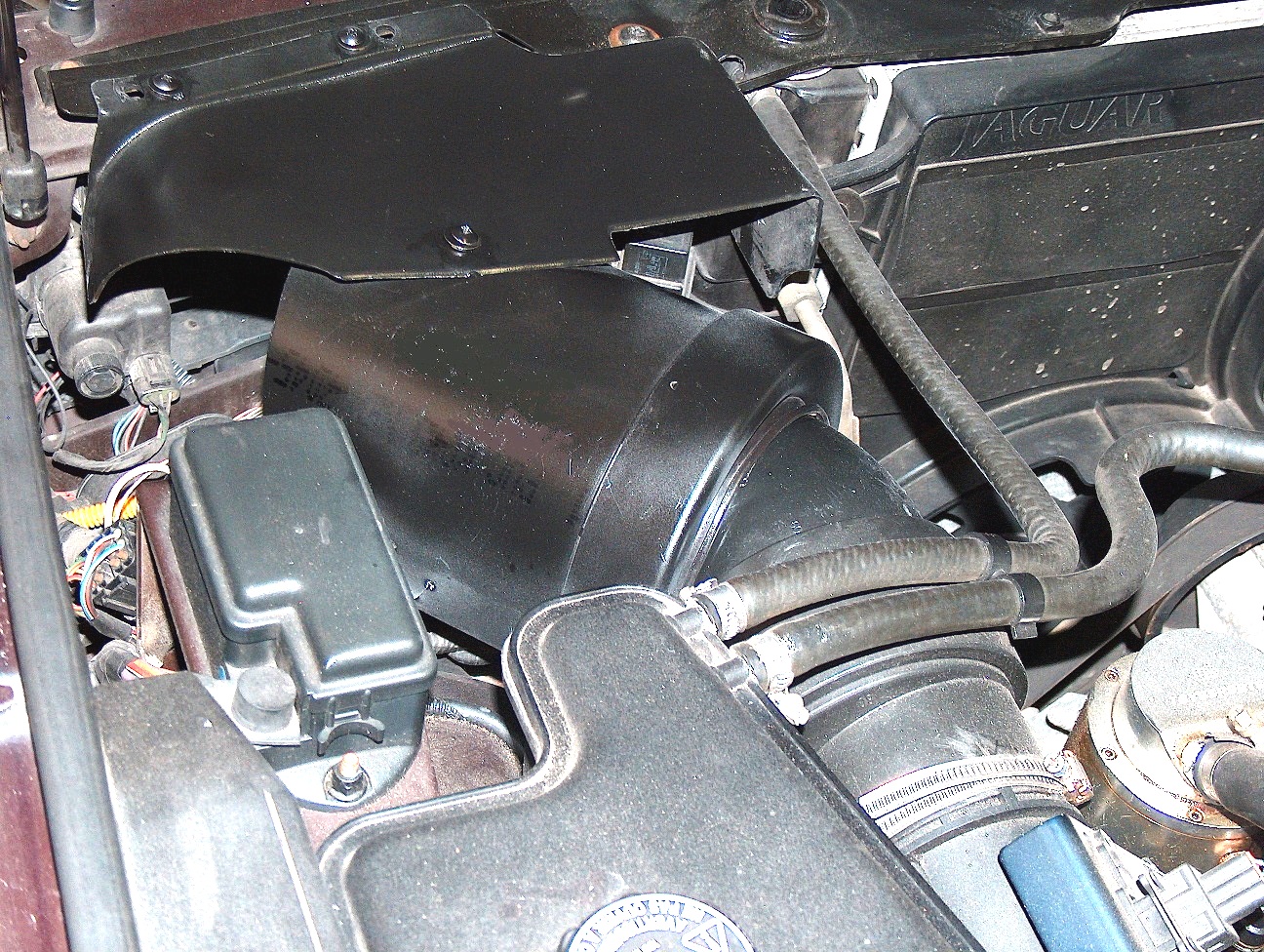

Attached Thumbnails 4.0 engine custom air intake setups?-hpim1132.jpg   4.0 engine custom air intake setups?-hpim1133.jpg   4.0 engine custom air intake setups?-hpim1136.jpg

Can you tell me what parts you used. This is very interesting. Some of the parts I would have no idea what they are.
The pipe is polyethylene(HDPE) and the filter housing is of poly vinyl Chloride pipe with a diameter of 160 mm. In a 160 mm end cap a hole made of 115 mm for the pipe. Diameter inlet filter is 115 mm. After the elbow piece go from 115 mm. with fitting to 83 mm.
