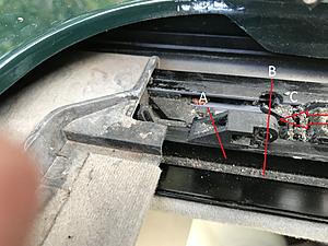

Below is a pic using paint putting in arrows in the area of interest . Mine is out of rig in that the top panel is 1/2 inch from closing as the previous owner had sealed it shut with sealer . I put the my sunroof on hold but decided to open that can of worms to repair it together . My motors do move the side rail parts around but come to a interference stop as they hit . It is suppose to rain heavily here Saturday and my pipes are off and and car outside so let me remove the headliner tonight to get my eyeballs on it then cover .
I will modify your pics as we go through this

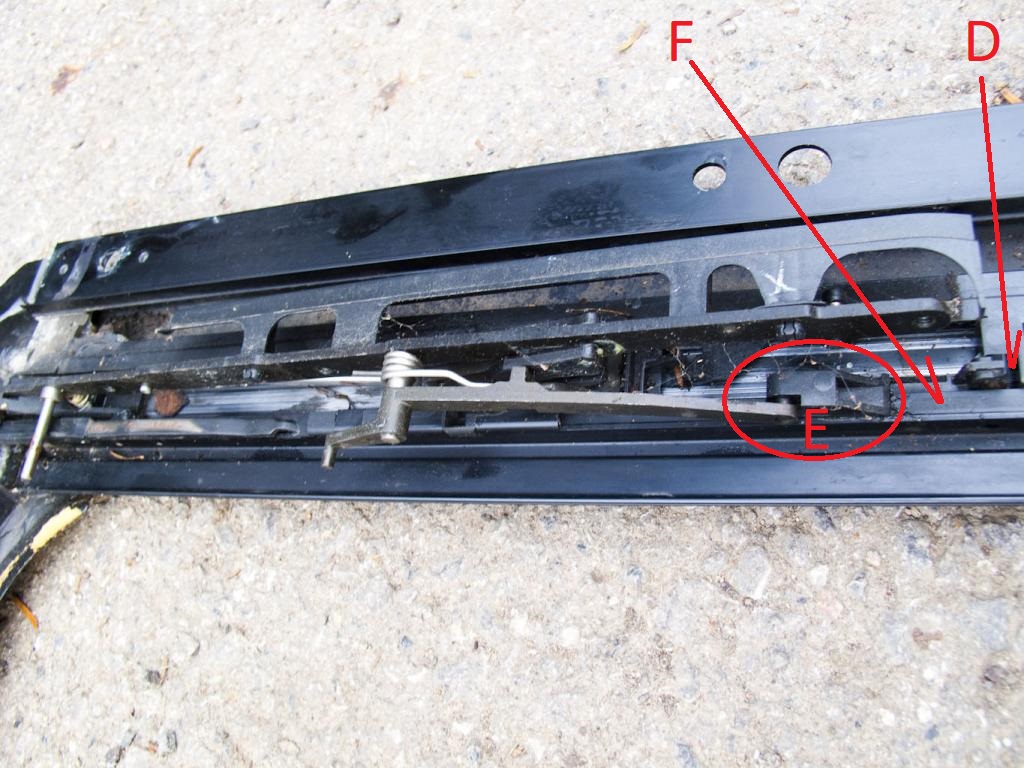

My inner panel is missing as the previous owner didn't have a clue and just punted . Along with the panel missing is the sliding rail (F ) I assume with the attach point ( E ) you say is broken on yours . I do have the metal arm it attaches to . Will have to source some parts before proceeding . Kept it sealed and looked from the bottom and this reference pic is from someone else
For yourself you might find the correct size brass tubing from a model airplane shop to be used as a bushing and build up the rest with the epoxy shown above . You can use a wooden dowel to line the bushing correctly and I would not expect to fully glue it up in one setting but just a tack to position the bushing in place and then fill in the rest of the pivot point void in later steps . With this you can use the short time cure as the longer will run all over the place before the set time before the complete cure time .
Let me know how it is cracked behind the pivot point and we'll see if a repair can be mapped out
Being out of alignment may be what caused it to break and is addressed in Jaguar TSB below :
I will be looking for a outer seal before I paint her if anyone knows a source HNA-1727-AE Sunroof Seal, 96- on ? Found it below :

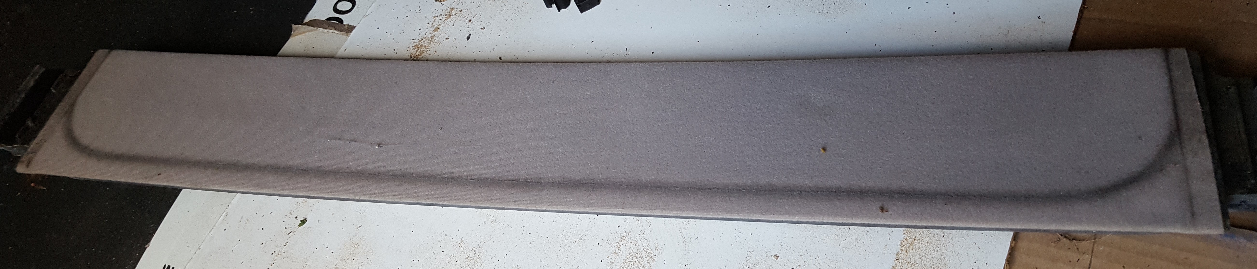

Just want to clarify things before I put anything in the post. I've attached pics of the two brackets/clips that you enquired about. Hope they do the job. On one of them, you might notice a small part of the tang on top is broken off, but this didn't seem to impact in any way. I've also included a pic of the part of the sunroof panel, which I think is what you need. You might just confirm same before I post them and if there are any other bits of the roof set up that I can post, let me know.
I'll sit tight until I hear from you and then they'll be on the way.
Attached Thumbnails '96 sunroof parts needed-20171017_172345.jpg   '96 sunroof parts needed-20171017_164519.jpg
someguywithajag (10-17-2017)
Old 10-17-2017, 01:08 PM
epreusser's Avatar
Join Date: Oct 2017
Location: Garrison NY
Posts: 10
Received 0 Likes on 0 Posts
Yes, those are the pieces I need, the long panel I am not in need of. Thank you SOOO MUCH!
