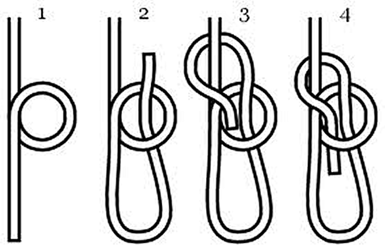

In order to make the downpipe to manifold assembly easier on car I cut the web between banks so to free up the 2 pipes from each other . Using a 1 inch " L " channel I drilled a hole about 9 inches from the end to pivit from the heat shield aftmost bolt . You'll end up ruining the bolt . I used a bowline knot with changing final loop dimensions I was able to walk the 2 pipes up without damaging the important donut flange . I had to switch the loop reach back and forth from one pipe then the other to walk them up . I tied a balled up rag on the upper end of the lever for hitting the windshield in the heat of battle without this protection would be big bad .
