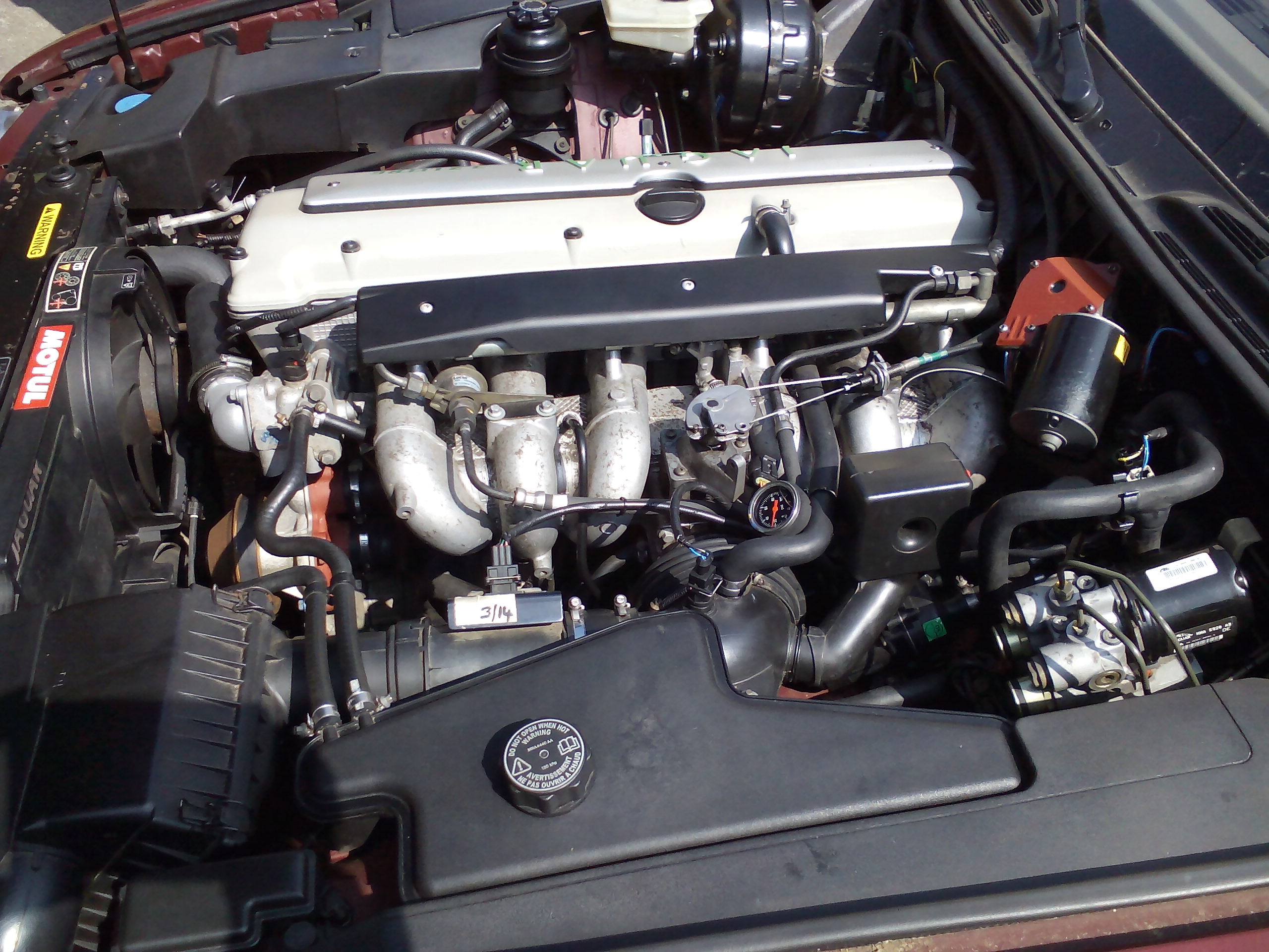

I have fitted a permanent Fuel pressure Gauge to the 5/16 fuel hose going to the fuel rail on my XJR as shown in photo attached.
Purchased was a Speco (Australian brand) small fuel pressure gauge for EFI, cost A$40, plus a 5/16 to 5/16 barbed fitting with a 1/8npt port to screw the gauge into. Just a matter of cutting the line inserting the barbed fitting with gauge already screwed in. Installation has been on my vehicle for several years, no problems, leaks etc. & you have ready reference check for fuel pressure when experiencing running problems. Just lift the hood & check.
