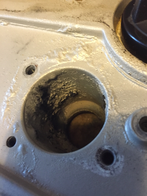

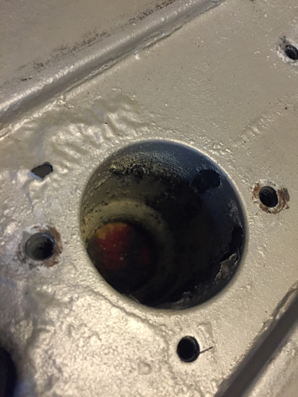

I'm calling BS on the corrosion on our cam covers not being from electrolysis . For corrosion you need an anode/cathode and electron path. Three of my plug wells had direct arcing as well as arcing out of the seam in the coil boot where it connects to the coil directly across from the arc marks. Our aircraft has tons of magnesium parts and operate in an extreme moist saltwater environment and I've never seen corrosion like I have on our cam covers on any of those parts. Difference, the aircraft parts are not exposed to electrical arcing. Coat your plug wells liberally and insulate your boots with sections of inner tubes.

I was immediately convinced one of the plug wells was damaged by electrolysis - it was so obvious simply by observation. One tell-tale sign was the fact that the coil in that position was the worse of the lot. The cracks were so bad, the light show was better than any disco I'd been in.
I don't see how the metal (bottom of well bore) was that cleanly "cut" because of some other type of corrosion. That area is not subject to vibration or any "odd" chemicals. It sits on top of a rubber type o-ring seal.
