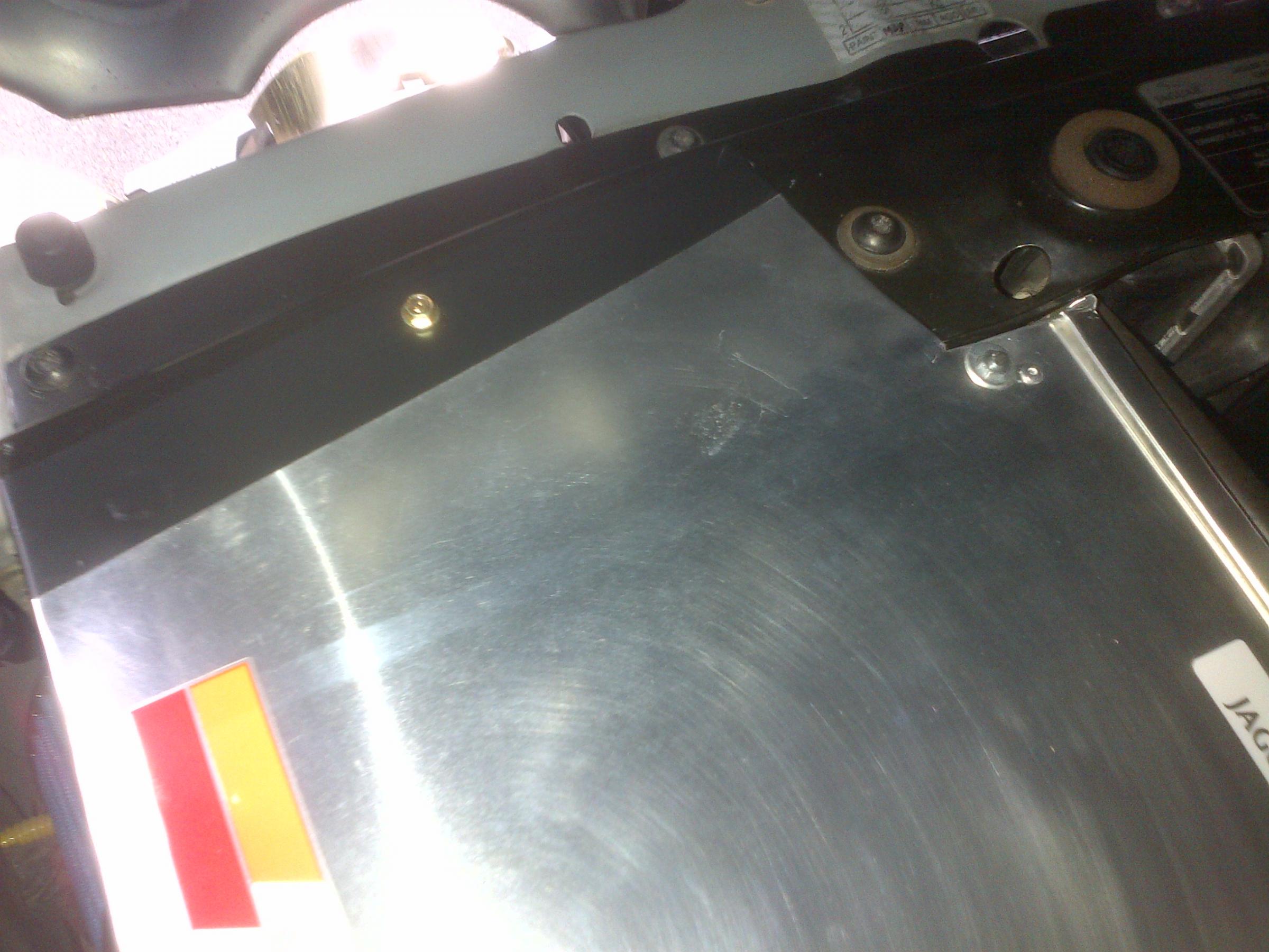

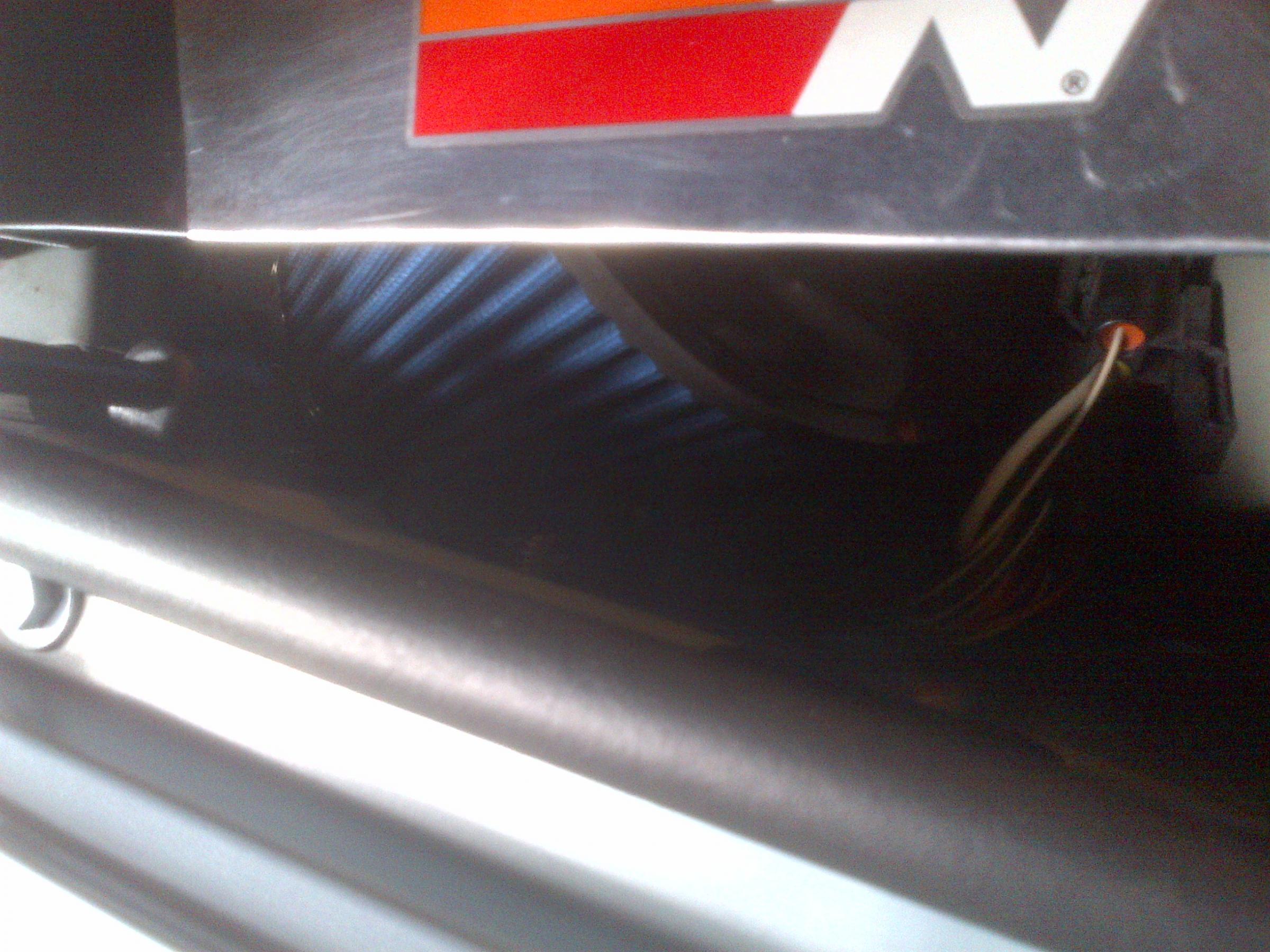

No worries, I'll take some pics and post them - give me a day or two to get to it.
The only real source of cold air is behind the headlights. Jag obviously thought the same as they positioned the intake flange for their standard air box in that position (and then stifled the air flow with a constricted set up!). Ideally the cone filter needs to be as far away from engine heat as possible. I fitted mine right into the headlight cavity, snug but it will fit. I then decided pulled it back a little to also take advantage of air coming through the existing hole in the inner wing, and that air directly hits the filter side on. The piping set up easy to fab, I used various 90mm PVC pipe sections & elbows, but could have used an after-market flexible pipe, although most of those are only plastic unless you pay dearly for silicone. I did use a silicone sleeve with a 100mm ring clamp for the first section which fits onto the MAS pipe.
The next step was to make up a heat shield to cover the filter and piping (top & engine facing). I used a 2mm polished aluminium sheet (sold at Bunnings) which is easy to cut and bend, and lined it with sections of 3mm cement sheet. IMO this is the most important component. After long hot runs the external surfaces of the shield are hot, particularly the engine facing one of course, but the inner lining and filter itself stays much, much cooler. The shield also acts as a splash guard to prevent the risk of water flinging up past the pulleys and onto the filter. I was caught in a storm recently and tested this very successfully! I made up some small brackets to mount the shield, anchoring to the existing air box mounting and a another behind the front relay box. It holds securely in place and no part of the shield touches the pod or piping and air is able to flow freely around them.
Admittedly it a was fiddly exercise over a couple of weekends with a few trial fits and tweaks to get it right, but it was a lot of fun to do and achieved a good outcome. Back soon with the pics.

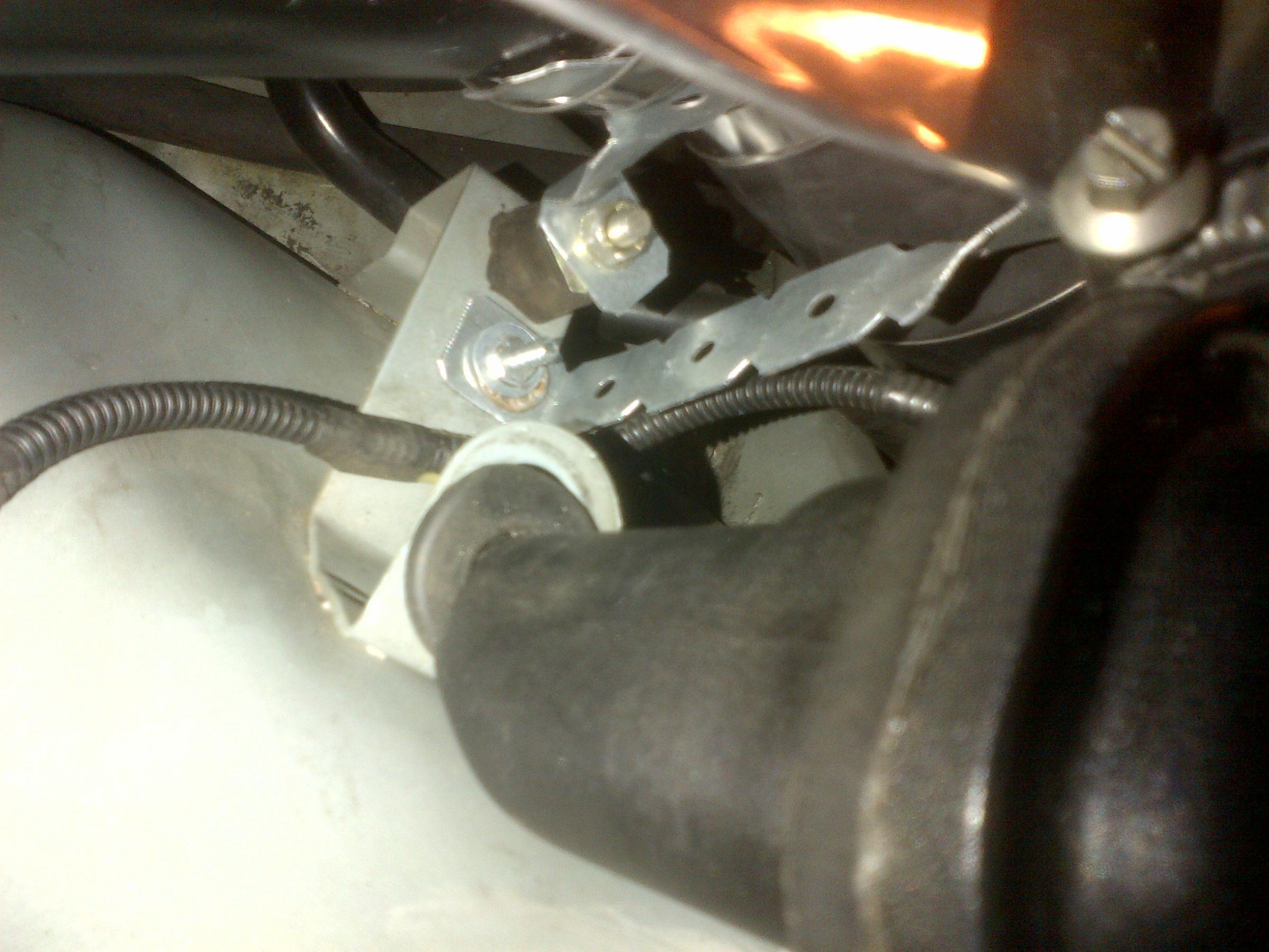

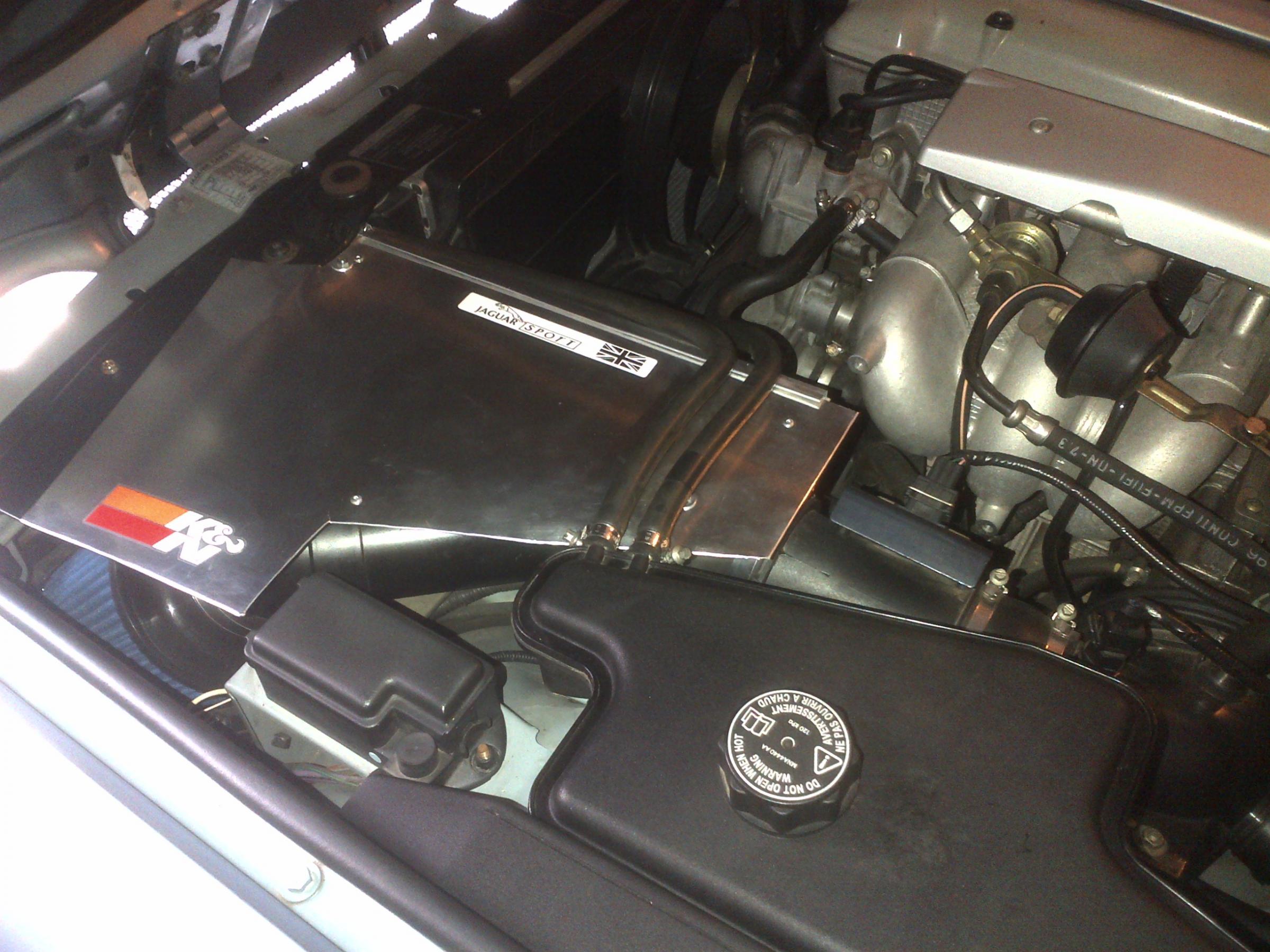

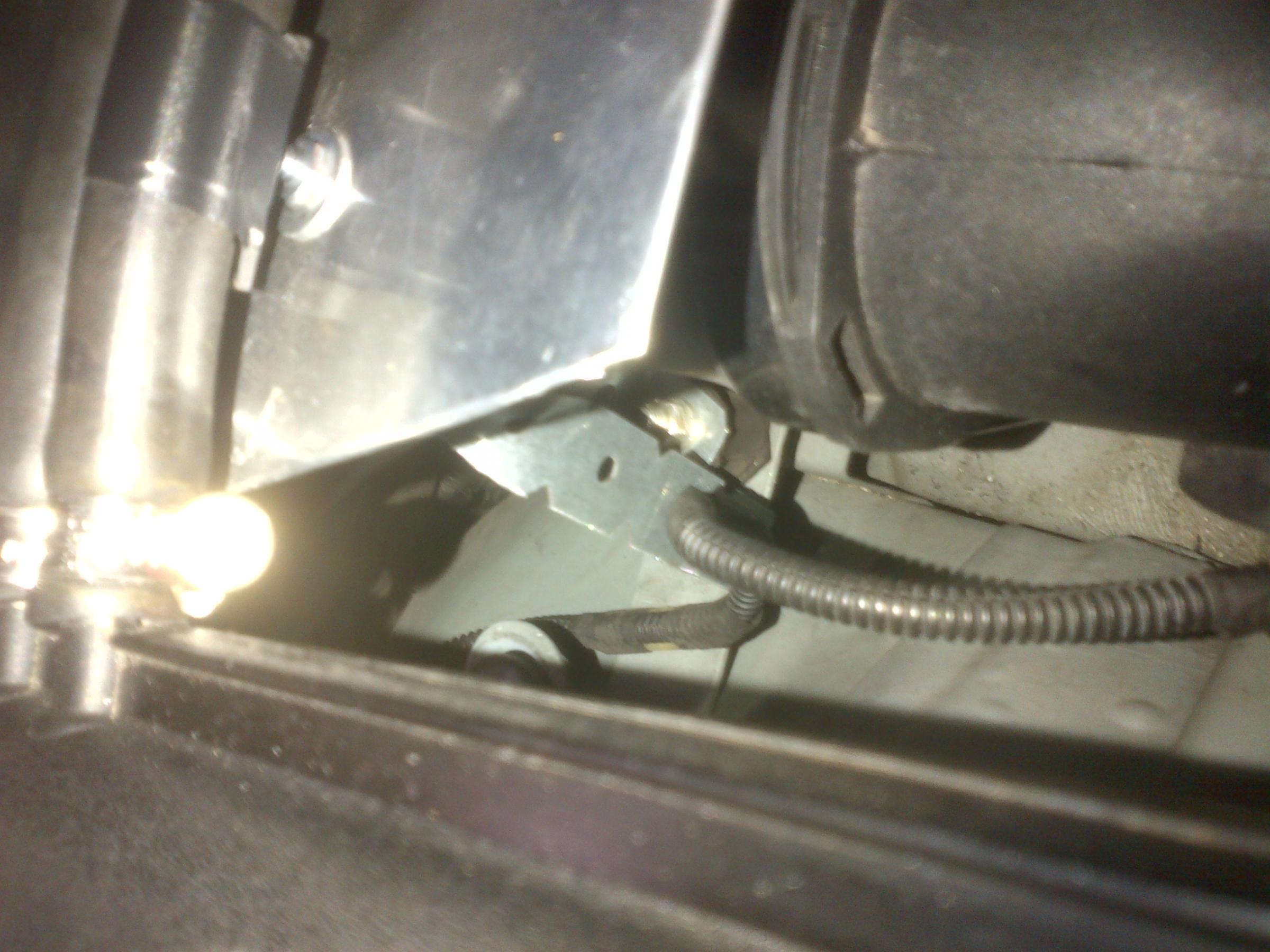

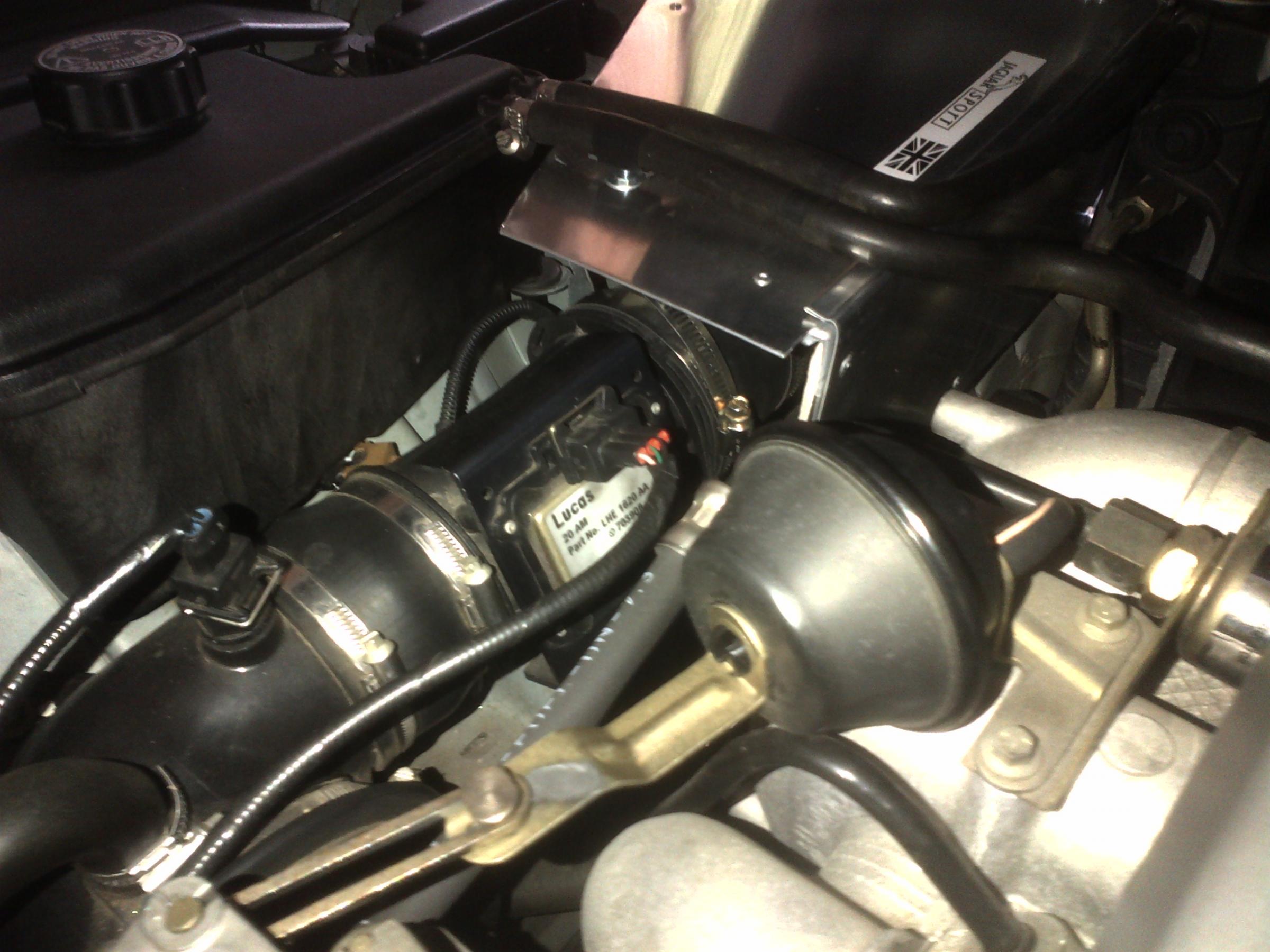

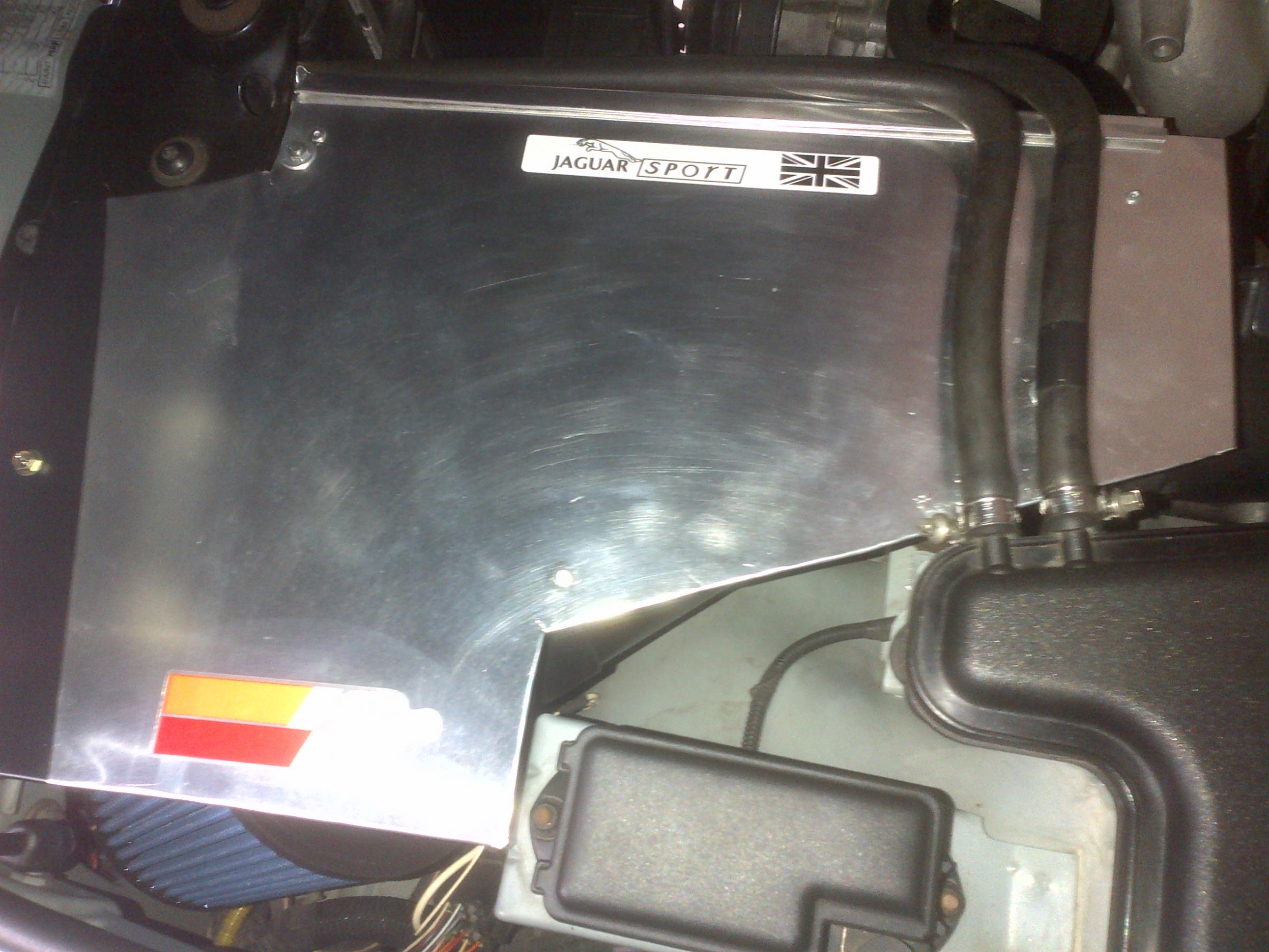

#224

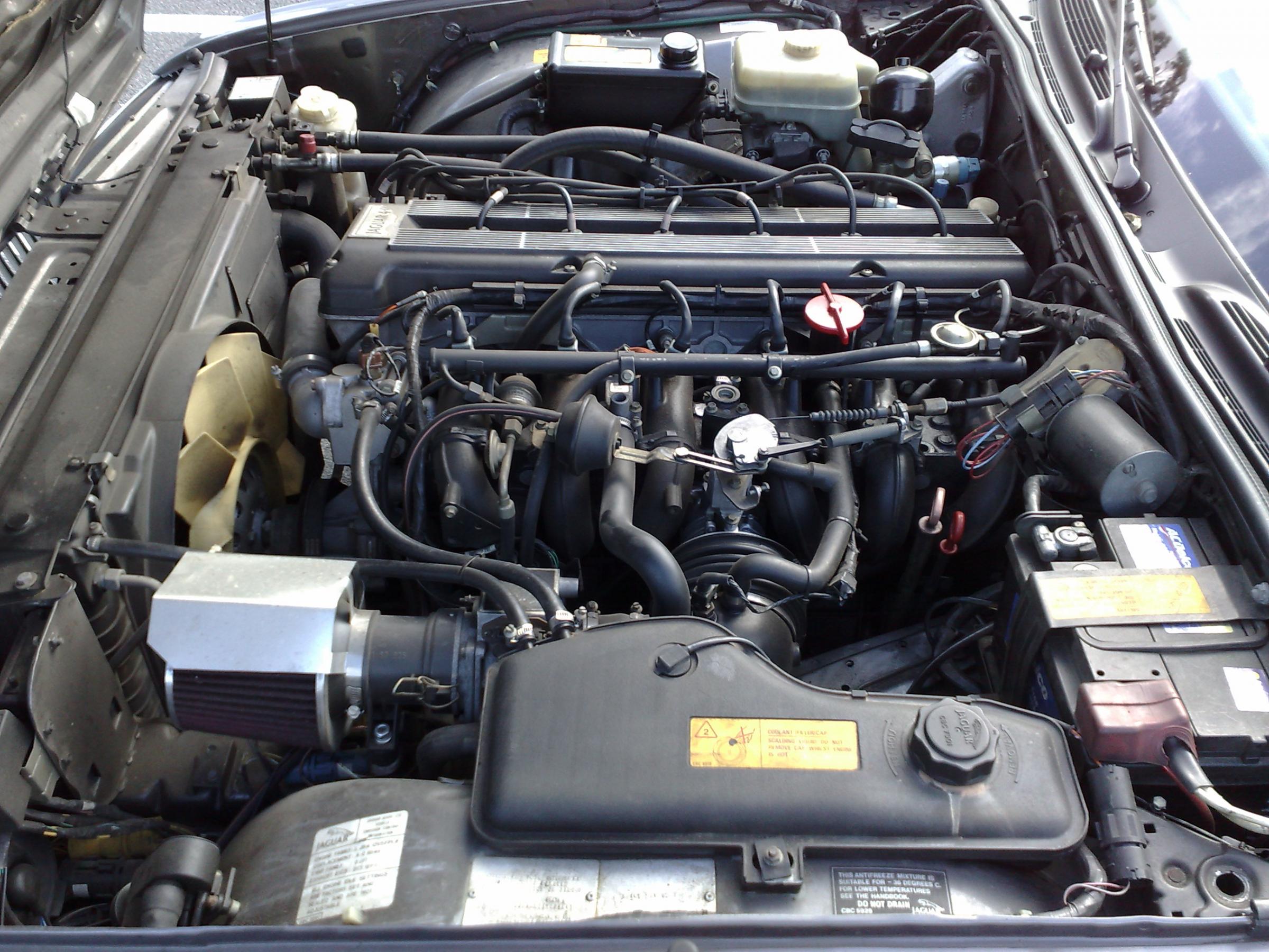

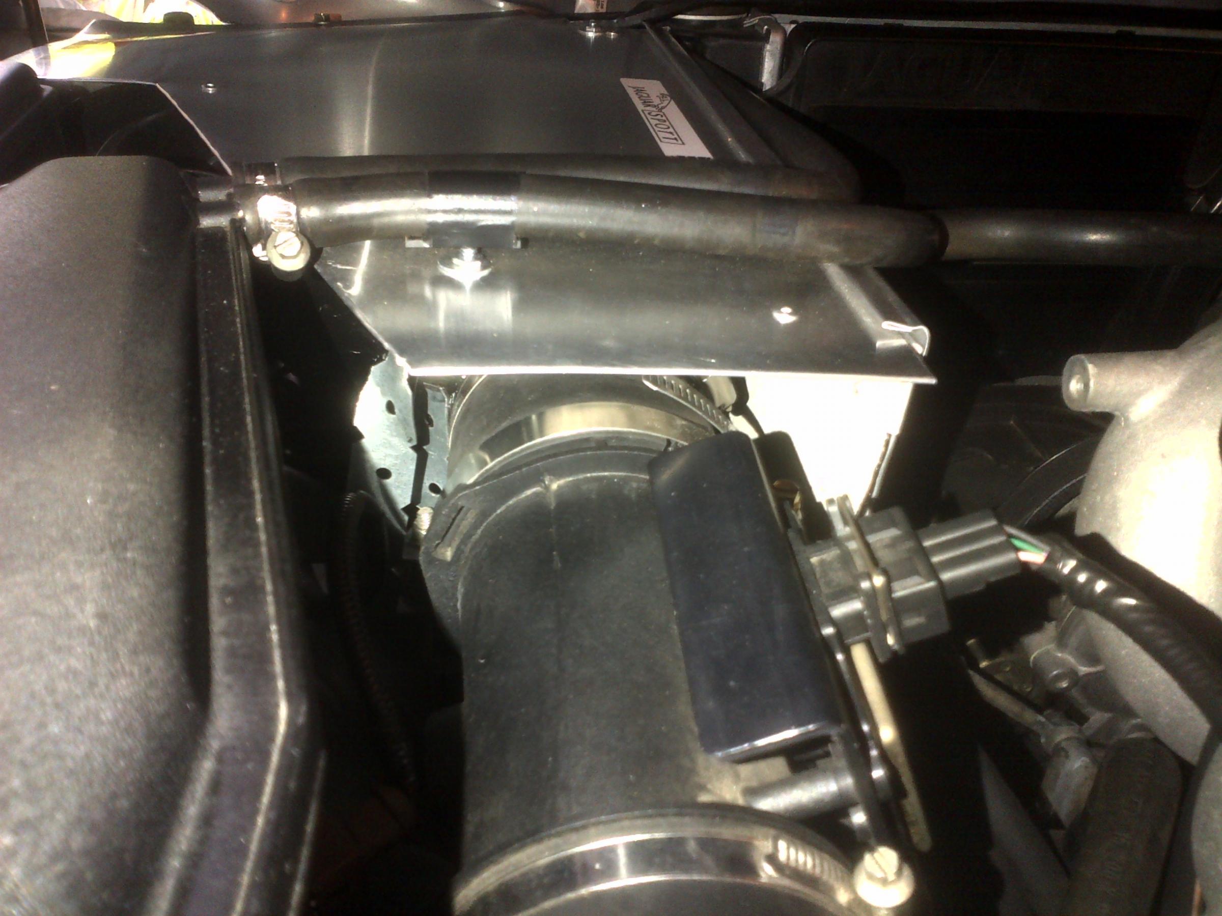

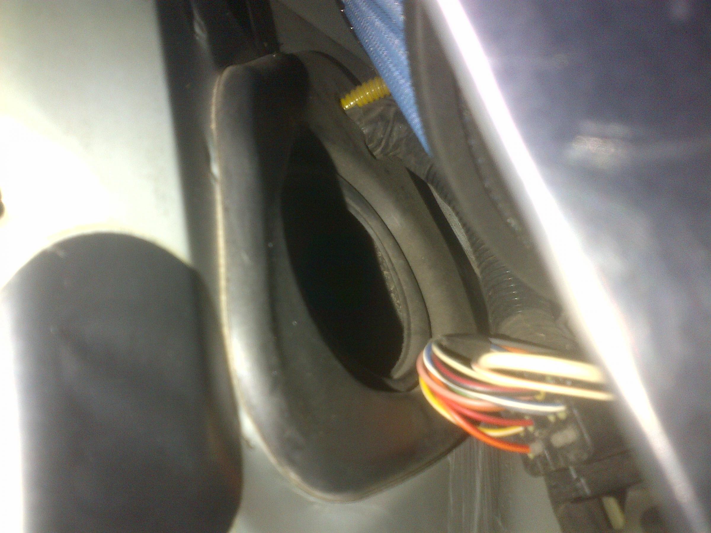

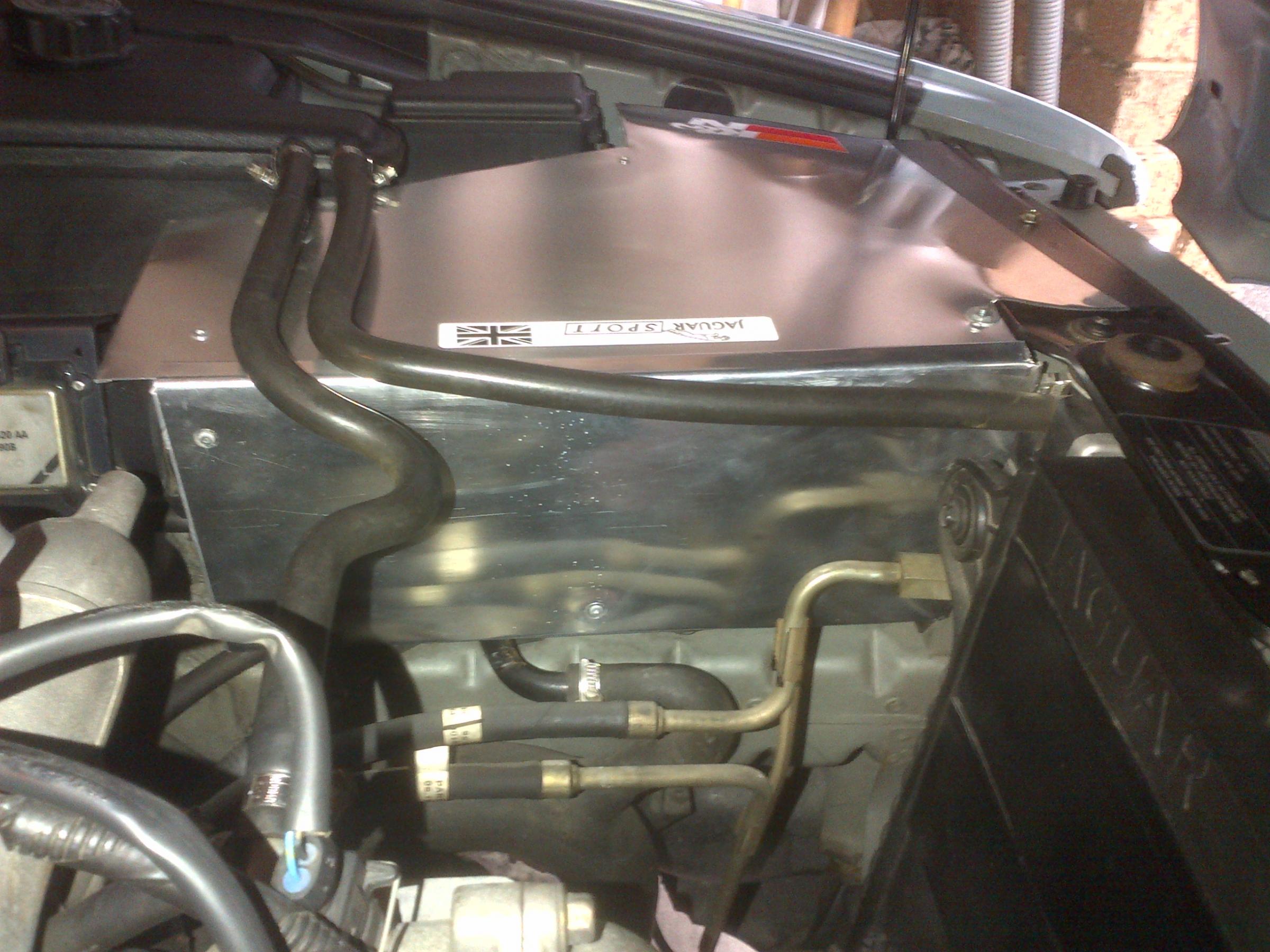

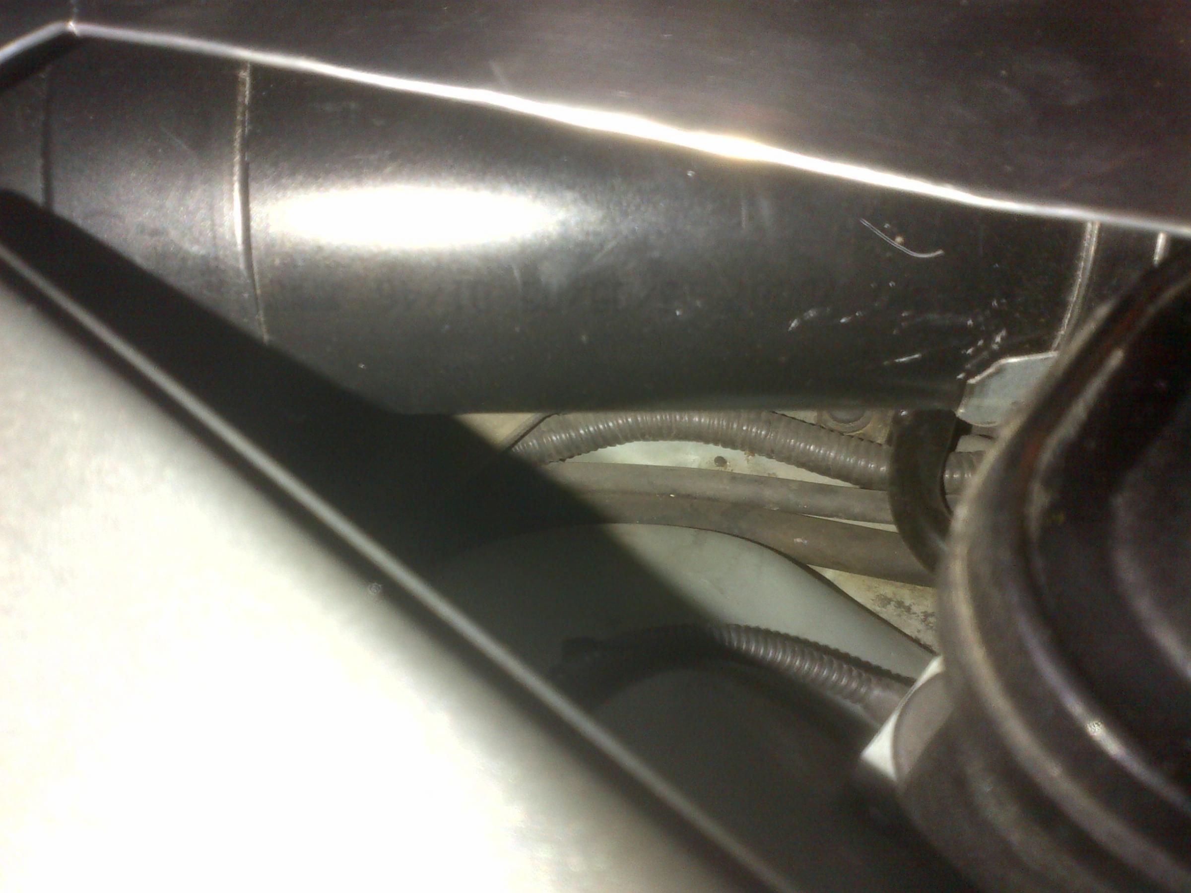

OK, here are the pics of my cold air intake. To save time and get these pics done I left the heat shield in place, but I'm sure you'll get a good idea of the set up (also ref. the previous description I gave). The shield removes in one piece and isn't too difficult for maintenance when really necessary, requiring 3 securing nuts to be undone. Disconnecting the header tank hoses to clear the way also makes it easier to remove (keep the hoses elevated and tied back to avoid losing coolant!).
I agree AL NZ, this set up together with Andy's bracket has totally transformed the 3.2 and I will confess to having tried it out on full throttle, although as I said previously I usually drive less enthusiastically to conserve fuel.
Hope this helps, let me know if not.

I fitted a 68mm diameter K&N filter. I bought it on a whim, estimating the diameter. It was a stretch, and once I had the filter box off I could measure the diameter, and it is 75-76mm. However my 68mm one fitted so I made do.
So get a 75-76 mm diameter one!

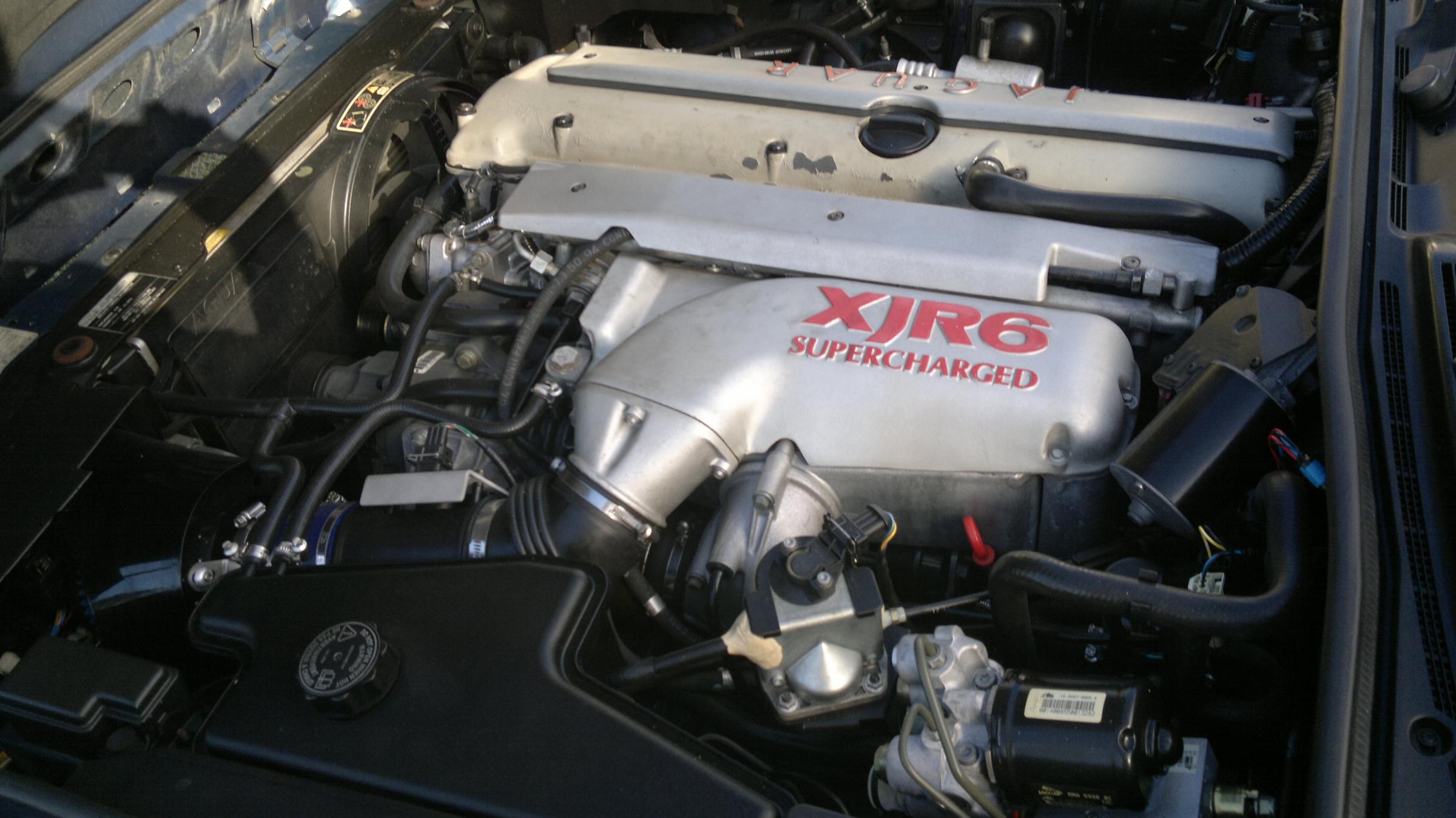

#236
I made the pipe from a piece of straight stainless exhaust tube and welded a washer onto it all sourced from local exhaust shop the pipe came from his scrap bin washer I had
I also fitted a shield to the pod as the belts will throw stuff at the filter not good if its raining getting the pod saturated
Also be careful using an oil type pod the oil killed my first 2 AFM,s they are hot wire type I use a non oiled type
the washer then mounts with one of these Square Cylindrical Vibration Mounts Rubber Neoprene Urethane Sorbothane Silicone Gel Ring Mounts Stud Nut Type to the original mount hole I used a large diameter mount to support the weight of the pod ,tube and AFM once you remove the original air box there is no support for the pod and AFM
on my old XJ40 I just cut the piece of tubing of the end of the air-box
I have attached a couple pics the XJR is a bit hard to see but you can get an idea of what I tried to do from the pics

Doc, your set up looks very similar to mine (N/A engine, not XJR) with the pod tucked right behind the headlight cavity and using the existing air box support mounting points (my posting with pics is earlier in this thread). Apart from helping to combat engine heat, I also felt it was important for the shield to protect the filter from dirt and splash up's. These filters are otherwise extremely exposed.
