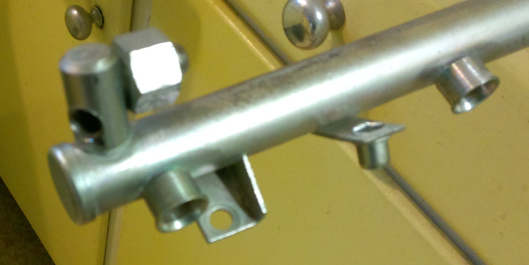

As part of my efforts to diagnose my non-running 1997 XJ6, I decided I really needed to get an accurate fuel pressure reading from the system. So After examining the situation and finding no good way to connect a pressure gauge into the system, I looked carefully at the fuel rail and decided to drill and tap a hole to a 1/8 NPT thread size. I will then install this modified fuel rail onto the car in place of the original one that is currently in place and then connect up my fuel pressure test gauge into this tapped hole.
See photos for the location and position of the tapped hole and installed pipe plug.
Attached Thumbnails Drilled and tapped hole in fuel rail-fuelrail_hole1.jpg   Drilled and tapped hole in fuel rail-fuelrail_wplug1.jpg   Drilled and tapped hole in fuel rail-fuelrail_wplug2.jpg

I drilled a hole in the FPR on the fuel rail fitting side on one of the hexnut flats . As the engine is running you should see 43 PSI and bumps up to 47 PSI on throttle up .

Jensen Healy I think your mod is potentially dangerous. I believe the method I used is much safer.
I fitted a tee between the feed hose and the fuel rail, with a hose leading to the pressure sender mounted off the engine where it was safe from vibration (actually used an existing bolt on the throttle cable servo). Unfortunately no photos of it fitted.
Using an electric gauge meant I could safely fit it where I could see it inside the car while the fuel under pressure was kept safely in the engine compartment.
The downside to this method is that the plastic fuel rail and injector cover did not fit over the tee without modification.
I admit it was difficult to find a tee with the correct threads and seal form.

YES! This was the exact problem. I was NOT able to find any match for the ball & socket type of connection on the fuel rail. If you can tell me where you found this T with the right connections then I would gladly change over to that instead. Also I did not intend to leave a gauge connected all of the time. My intention was to only have a gauge attached when I am troubleshooting. When not in use for troubleshooting my intention was to have the 1/8 pipe plug installed with appropriate sealant.
To be clear I drilled this hole in a spare fuel rail I had lying about. I still have the original unmodified fuel rail that does not have a hole drilled into it.

Looked to be a round ball toilet plumbing fitting I could never find and has to be placed on either end of the fuel rail as that is the regulated fuel pressure .Clean up the inside seat where the injectors install as this is the most critical and hidden area . In doing a leak check place some smooth writing paper under the injectors to see any drips . A paper towel is harder to see evidence of a leak .
If you used your drilled fuel rail you might end up with a smoking hole in the ground....
