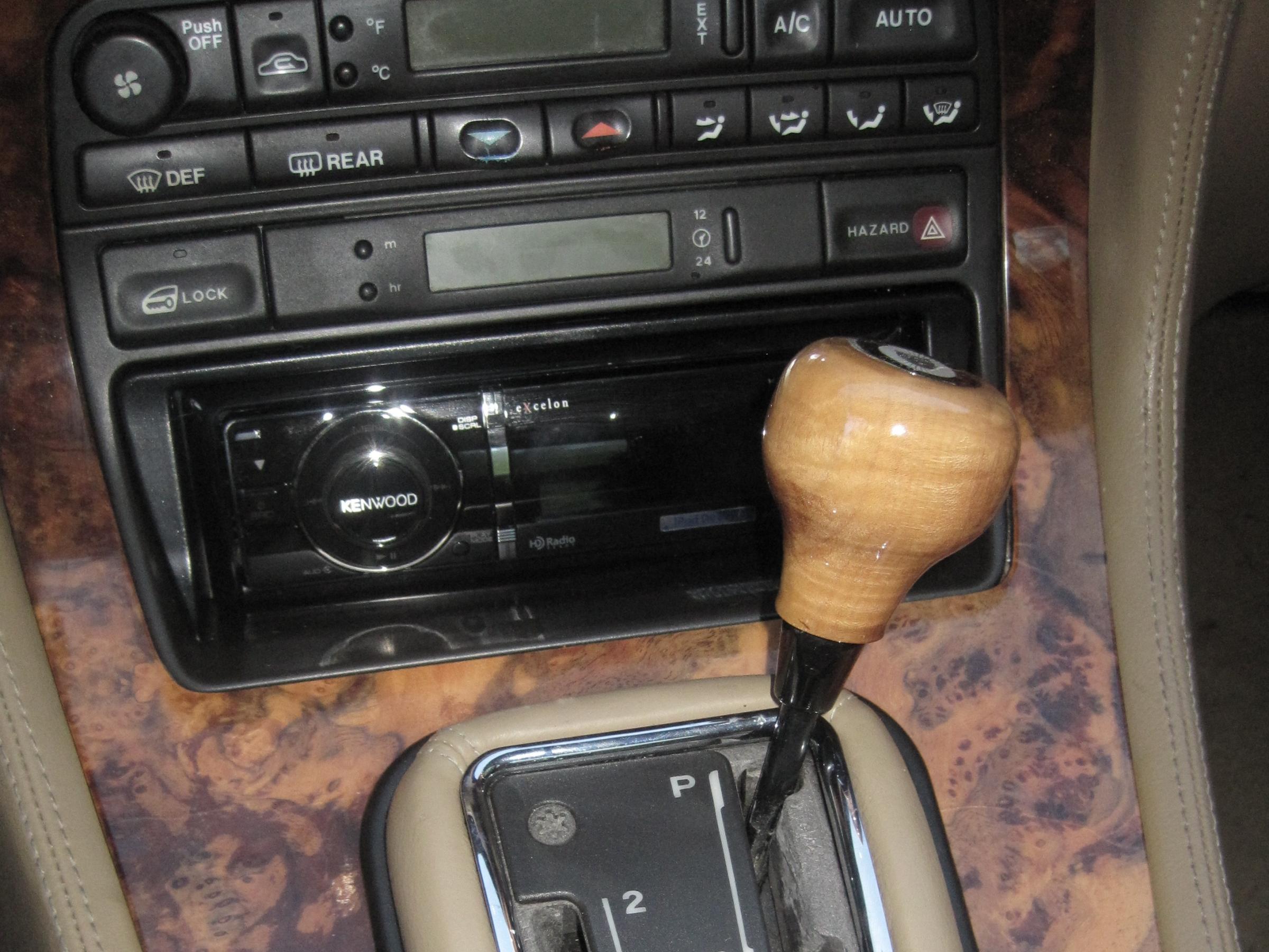

Thanks for the info on getting my clock reworked!
Here is mine...
