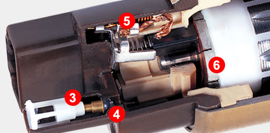

BTW, this is some additional information on the Denso fuel pumps, noting their integrated check valve:
Products | Fuel Pumps
3. Check Valve
Maintains consistent system pressure for superior hot fuel handling characteristics.
Attached Thumbnails Fuel pressure check (backflow preventing) valve, where located?-commercial-vehicle-ld-fuelpump2.jpg
