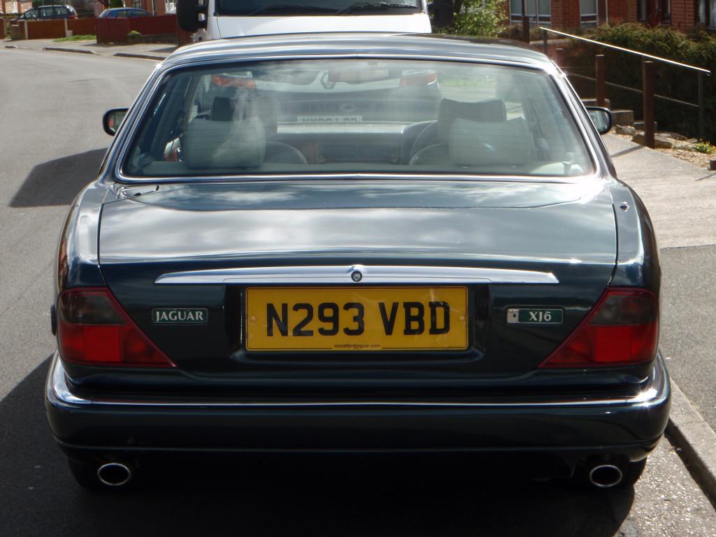

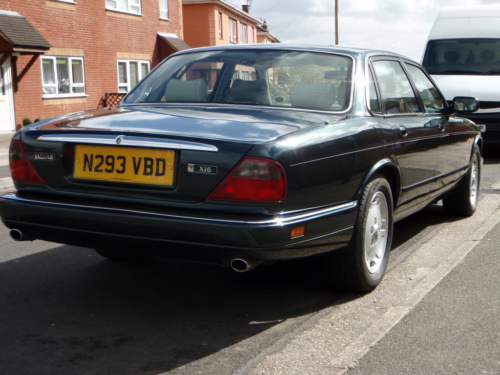

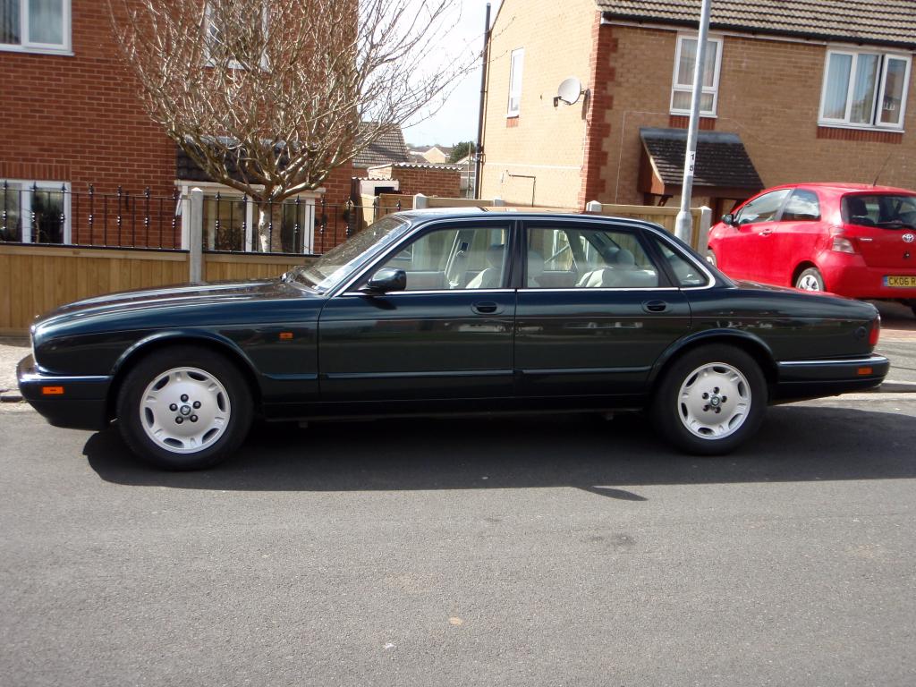

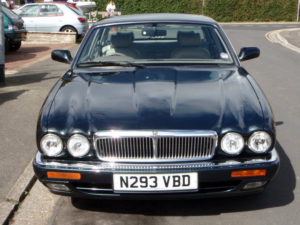

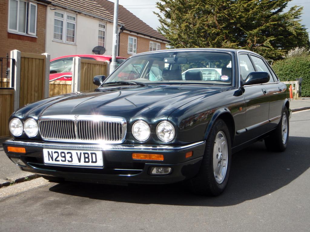

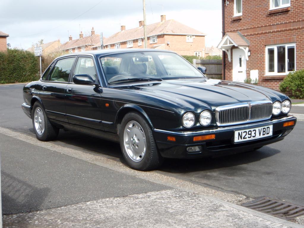

Some of you may have seen me in the new members forum, but just in case some haven't, last week saw me cleaning, polishing and waxing the Jag on a lovely sunny morning. I only got rained on once (halfway through polishing) so had to have a coffee break. All in, that's 5 hours of buffing. I'm sure my arms were going to fall off by the end, no machine polishers here!

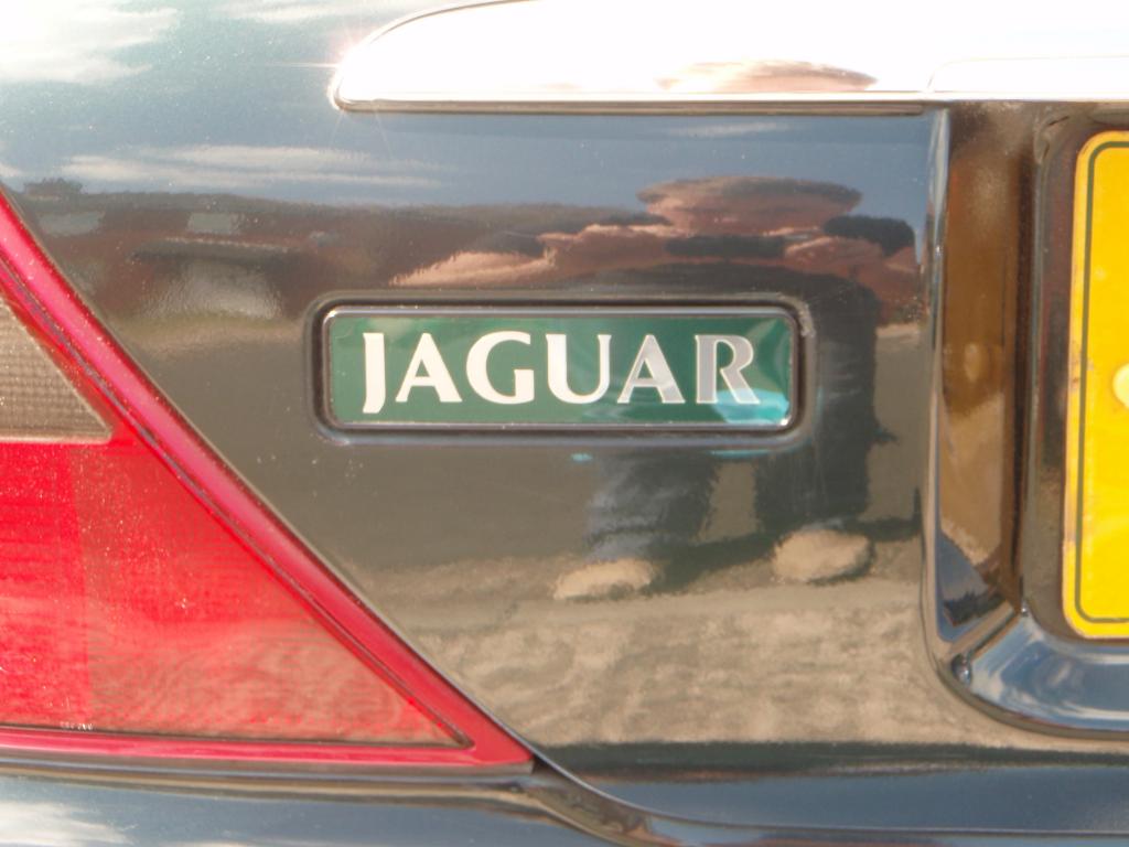

It came up really shiny, especially from a couple of feet away. But the paint on the bonnet, roof and boot is quite bad, if you look closely, you'll see that half of the bonnet is dull and one side is scraped off. The roof is starting to orange peel and the boot is hazy and coarse. There are a couple of dings on the doors but the rear wings are very good! Both front wings are bubbling, one very badly and both bumpers are bad. The front bumper looks like the surface of the moon with it's chip craters, the back just has tar and smaller pits/chips. Nearly all of the brightwork is very good, the bootlid top bit is just a bit scratched and worn.

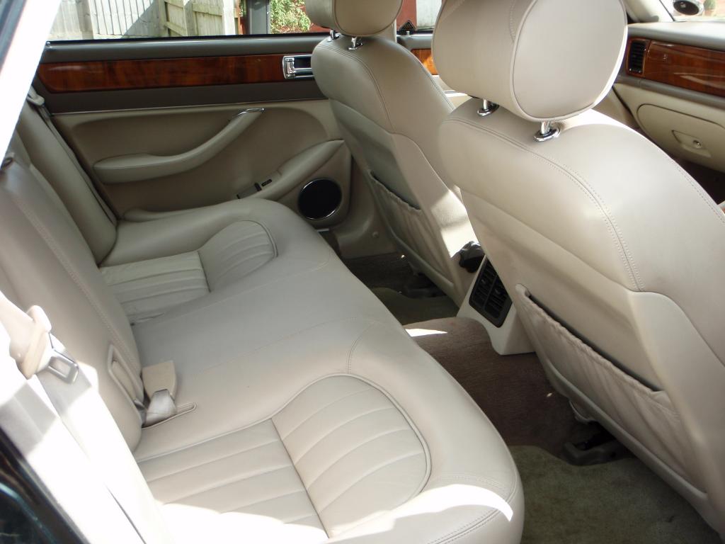

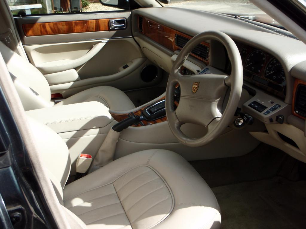

Inside I had no time or energy to clean, so it's as it is - which is pretty good. I would like some new car mats, and there are a couple of carpet bits that need shampooing to remove ingrained dirt or ink or something. The leather is rather good though, as is the dash.
All in all, I love it! So far cost wise (including LPG and petrol usage) it has averaged 31.1 MPG and it isn't running right on LPG either, it's alot slower and has been doing 13-20 MPG. So when I get it running properly, it'll be a rather cheap Jag to run

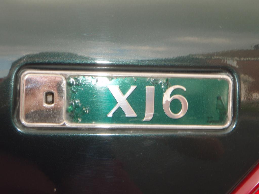

Hi all, I finally got around to getting my new badges on! Bought the boot pair to pad out a parts order a while back to avoid paying £23 delivery :O I have only just realised that I seem to have bought a sport 'Jaguar' badge as it has no chrome around the edge, but I quite like the effect.
Before:
After:
Washed her and had a good buff over, very please to see after several weeks of no cleaning, she's still very shiny. Good old wax, eh!
Really need to get going with new wheels/tyres (as this warm weather will be wearing down the winter tyres very quickly) and a replacement exhaust section (underfloor cat section, before the split into 2 pipes) as she's blowin' like a good un, sounds very nice - but quite drone-ish at 60/70. Also spotted the buibbles on the drivers wing have flaked some paint off, best get them seen to too... Good used wing I reckon, why not make it a pair and get the other side sorted.
Cheers.
