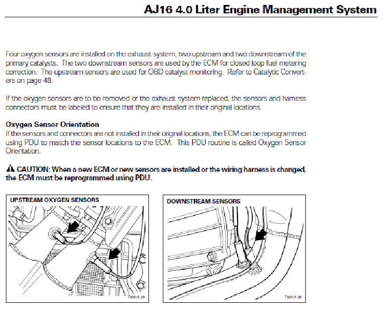

Are Rest of World AJ16 normally exasperated engines 2 x O2 sensor configurations ( North American has 4 ) located forward of the forward Cat ? Mine has the 4 sensors so I can't say . But the All of World wiring schematic for the supercharged AJ16 engine always has 4 . Does this make the forward sensor the ones responsible for the fuel trim and the aft ( if installed ) only responsible to verify the Cat is functioning in it's outgas conversion as a thrown code 420 ? Forward O2 sensors are easier to tinker with if that is the case . They can be removed and soaked in gasoline ( not the wires ) overnight to possibly refresh them and read accurately without being clouded
http://www.jagrepair.com/images/Trai...20-%202000.pdf
Although the Jaguar Engine Management Systems document 801S page 80 says the aft sensors controls the trim are they in error , Boeing documents were not always correct .
Cracked exhaust manifolds and damaged downpipe donut gaskets / flange ( as you recently had them removed ) will draw in fresh higher O2 and bias the sensors to make the engine trim rich . As well as a intake manifold vacuum leak in the idle area of operation .
Correct plugs and clean sensors would be a foundation to build from as you correct the engines regulation .
