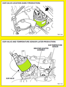

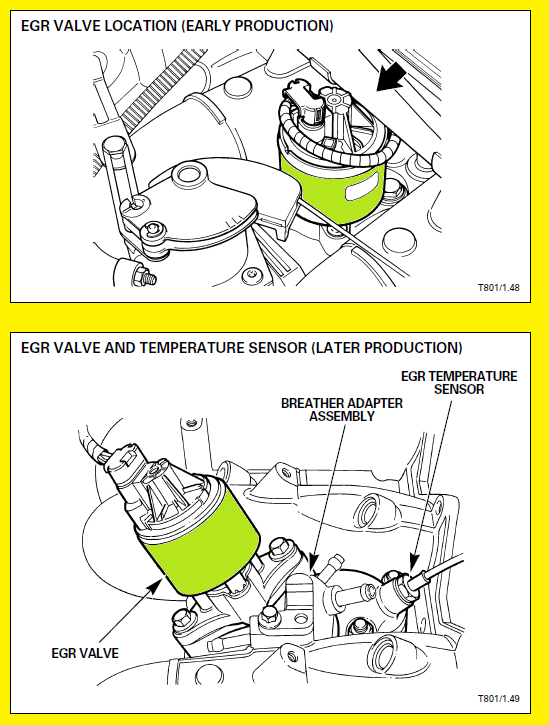

Old 09-25-2017, 12:50 AM
Qvhk's Avatar
Join Date: Mar 2013
Location: Hong Kong
Posts: 1,026
Received 280 Likes on 208 Posts
Here are the diagram and picture showing where the EGR valve is and how it looks like.
Some X300 sold in other regions don't have it fitted.
  #29
Old 09-25-2017, 01:25 AM
Lady Penelope's Avatar
Join Date: Apr 2017
Location: Kansas City USA
Posts: 4,039
Received 1,387 Likes on 1,090 Posts
For the not lucky to have a Supercharged model and is normally aspirated it looks like this with no tubing to get around the SC intercooler
Attached Thumbnails Stalling's frustrating club of Jaguar x300-x300-egr-l-untitled.png
