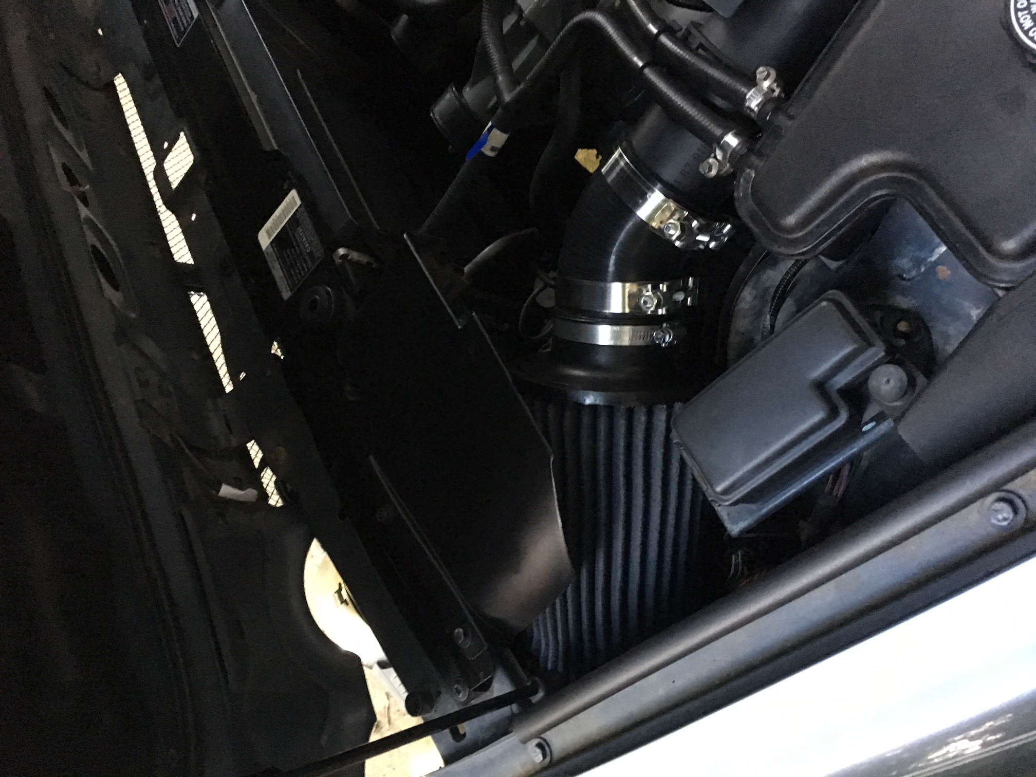

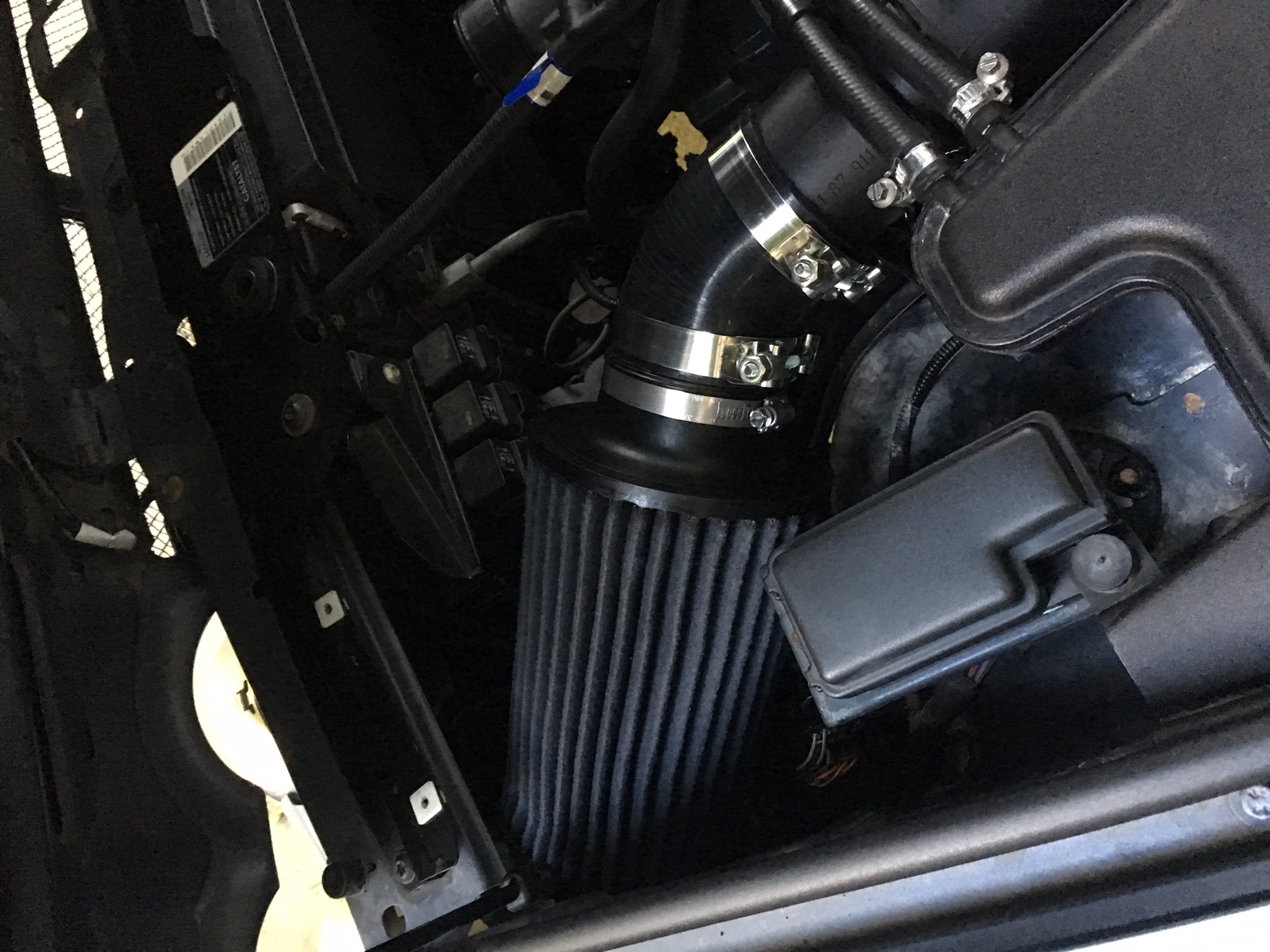

Well, as is often pointed out, when one rolls up their sleeves and works on things themselves.... you get very familiar with how things are put together, and troubleshooting issues become much less difficult and stressful
....so my cruise control quit yesterday, and if I hadn't just disassembled the entire intake tract recently to clean the intake and TB, I might not have known where to start looking.
However, I distinctly recalled that the vacuum line was a bit stretched and loose where it connected to the cruise control bellows, and indeed the line had slipped off. So a couple minutes, and fixed! Of course I need to get some new vacuum line, and maybe a spring clamp now, but no big deal
Also, fitted an AEM "Dry Flow" cone filter that doesn't use oil and replaced the stock airbox. The part number is AEM (21-2039BF) and at 9.25 inches long just barely fits after I relocated one relay to an empty location on the front of the bracket and relocated another electrical connector, but it does fit with the use of a trimmed down 45 degree elbow. If you were to get the slightly smaller 21-2038BF (8") it might be a slightly cleaner and more user friendly install. If I had it to do again, I'd probably use the 21-2038BF. I used an old airbox to cut off and donate the intake throat that clips to the front of the MAF so the connection looks somewhat OEM and is supported by the factory stud.
I'm not really sold on the whole "cold air induction" mania, so I'm not going to bother with trying to build a box around the filter, plus there is plenty of "cold air" entering through the headlights and the hole in the fender/wing for the OEM "cold air" solution in my opinion.
But I am sold on giving the engine some better breathing, and I can tell you the engine is definitely snappier with the stock airbox replaced with this filter. With this filter I have practically tripled the surface area over OEM, and just via a "sucking" test, I can tell it is much easier to pull air through than the OEM filter and box.
Plus you can now really hear the supercharger from within the car when opening it up
Attached Thumbnails What did you do to your X300 today?-img_0932.jpg   What did you do to your X300 today?-img_0935.jpg

Al, I had an almost identical set-up to your cone filter on my XJR, but I got sick of air flow meter issues so reverted to stock air box. I really don't think there is much in it. I then put on a spare air box lid I had, where I have cut out a large rectangular hole in the top to let in more air, and I can hear the supercharger whine under full throttle.
However I think a decent length of pipe between the cone filter and the AFM is important : when using a cone pod filter, I initially clamped it straight on the front end of the AFM. I think the air flow is probably too turbulent from just emerging from the pod when it hits the meter, done this way. When I put a long elbow on it like yours, the difference was very significant. This difference may reflect it is getting colder air on a longer pipe, but I don't think so - at 100 km/h, there is plenty of cold air every where.
I think a good air flow meter is key to keeping the XJR running properly. I have had issues with the original OEM ones, and new 'genuine' ones are unavailable. I have tried one of those no-name ones from the internet (about £99 from memory) and it worked well so I will get another as spare.
I agree completely on the need to smooth the airflow before the MAF, and that the filter will get plenty of "cool air" at speed even without a snorkel or box.
Years ago some of us in the Moto Guzzi V11 community did a bunch of dyno testing with pod filters directly attached to the TBs, velocity stacks, stock and modified airboxes, etc. And the worst performers were the pod filters directly attached to the TB, and perhaps surprisingly the best performers kept the stock airbox with some opened up snorkels. Analysis by some of the engineers looking at flow, etc said this was because the airbox served to calm the air and guide it smoothly into the TB/intake. And this was without a MAF (open loop FI).
That's why I salvaged the throat from a stock airbox to mount to the MAF and then another approx 4 inches length silicone 45 degree elbow, and what you can't see is the 3 inch diameter aluminum tube that joins the 45 degree elbow and filter flange. That 3 inch diameter aluminum tube is also salvaged from the duct that connects the XJR6 intake to the TB. This tube extends another approx 3 inches inside the cone filter. So I've probably got close to another 7-9 inches of tubing to smooth the airflow before it hits the MAF. That was my goal there.
Another thought on the "cold air" is my friend's recent experience with his fan clutch dying this week on his truck. At speed, no problem, the truck would operate at normal temperature. Standing still, it would overheat. My point? At speed there was enough "cold (ambient) air" to flow through the radiator and into the engine bay to keep it cool. That same air is being rammed in our cars past the headlights, in through the side wing/fender "cold air" airbox hole and yes, through the radiator. So I don't think there is great benefit in trying to isolate the filter, other than it is fun as an aesthetic project.... and that I totally understand
Can you link to the no-name MAF you bought?
Since the OEM is unobtanium, this would be good to know for XJR6 owners
