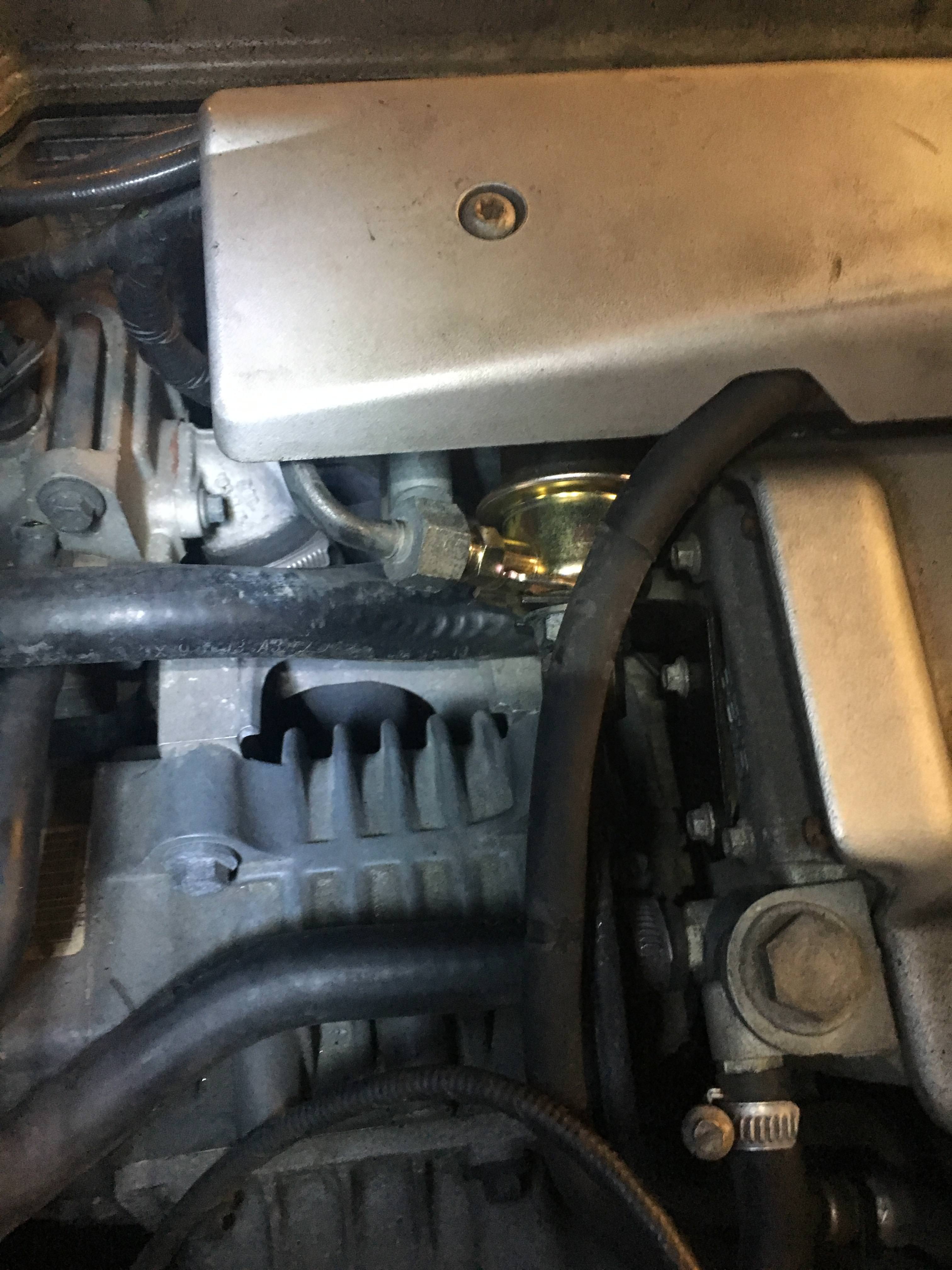

It went to me! It's been a great car, but it started having some surging issues (irrelevant of RPM) and there was a fuel smell in the cabin. So, I replaced the fuel pressure regulator, which eliminated the fuel smell in the cabin, but the surging remains. Hoping that the CTS that I ordered will fix that. I've also replaced one of the trunk struts and a friend helped me install X308 headlights, which now need adjusting!

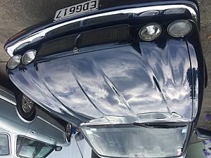

New Year’s Eve - didn’t do much to the car.
Just a spot of wash, polish and wax, and changed the XJR’s sparking plugs from Champion RC12YC to a cooler 9YC at Andy’s suggestion. 4 of the 6 plugs needed gapping to .035" as they were much narrower out of the box. the other two were already right.
