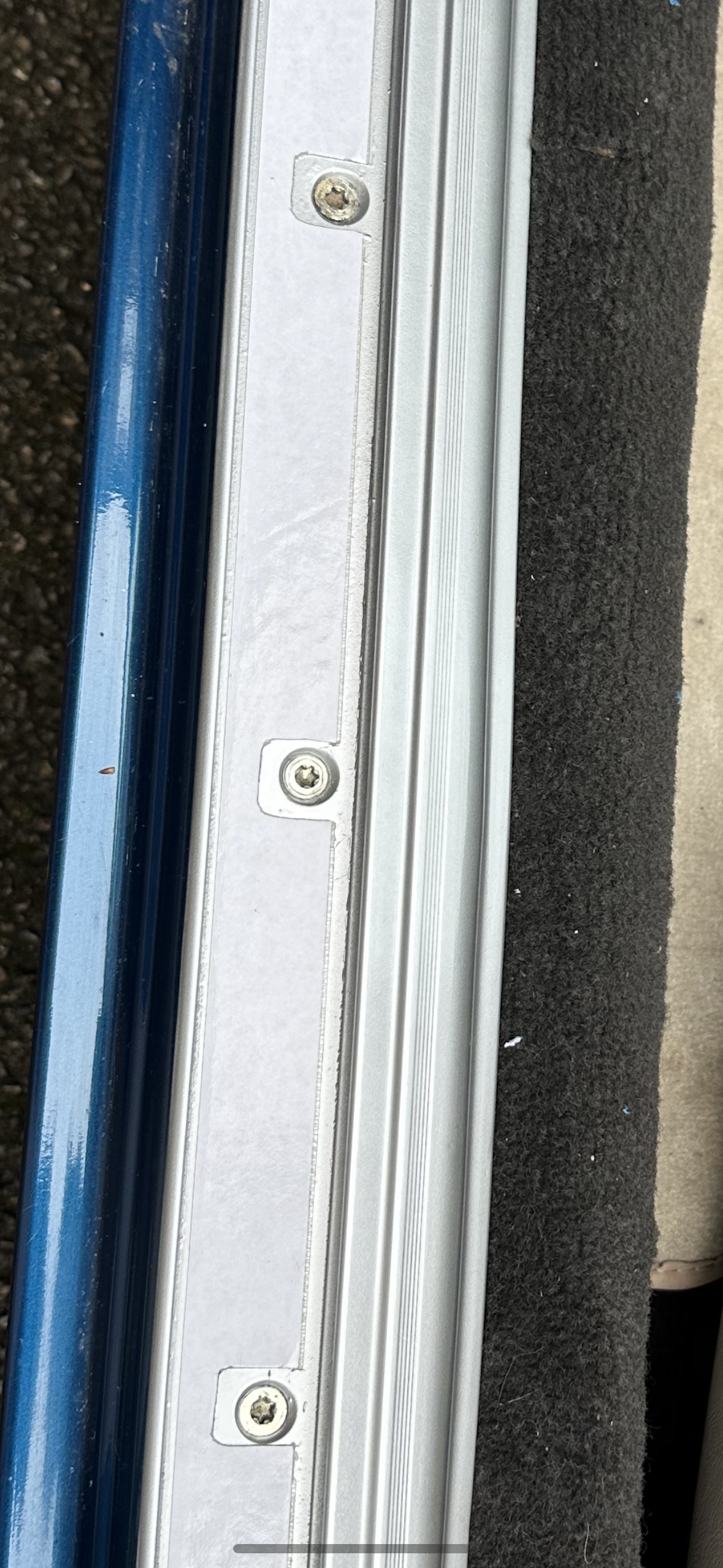

Default Tread plates
This weekend I took a hammer.. and a vice, wet-stone, 800/1500/3000 grit paper, etch primer, “soft silver top coat and lacquer to the tread plates in my 96 XJR.
I guess someone previously tried to pry up the plate with a screw driver as it’s flat edge was anything but flat.
The end caps are no longer available so I’ll not fit the insert until I find some end caps …
Before painting
Ready for end caps and inserts
