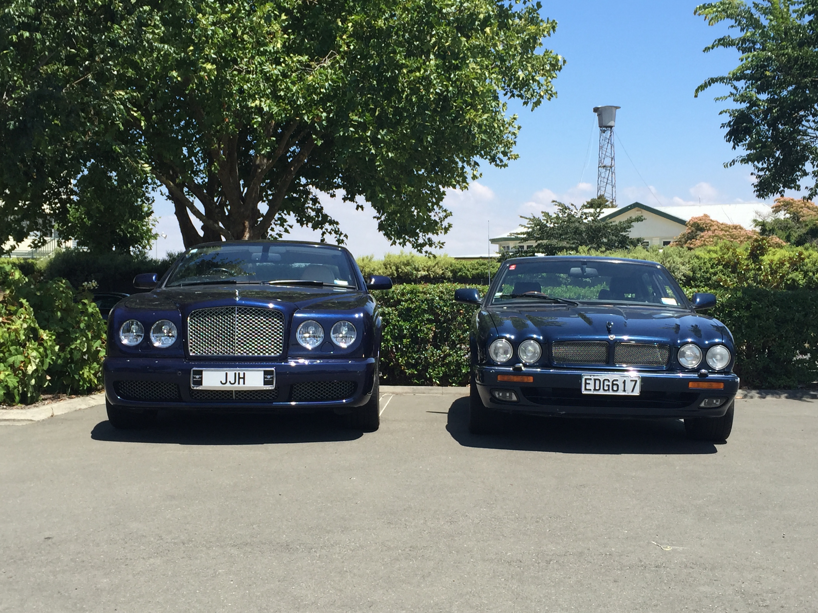

Wash and quik wax...
the big bruiser Bentley is jealous - his grille is only chromey plastic!

Yeah, amazing that so many hyper-expensive cars, even current Jags, now have nothing but chrome plated plastic grilles. Sad.
