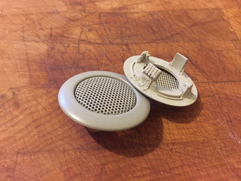

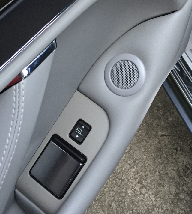

After almost two years, I finally got around to repairing and replacing the tweeter speaker covers for the rear door armrests. The LH side has been completely off/out the whole time, and the RH side was just glued in and as such sort of "floated" loosely attached to the skin of the vinyl armrest.
It seems that most of these covers fail at some point where the clips break off due to time and stress and then the covers and sometimes even tweeters themselves disappear. I've seen many of these obviously glued back in, so often that I suspect dealers even did it when they couldn't get parts anymore or knew it was pointless as the clips would soon break again even on new ones.
But I recently found a tan pair on a wrecked XJ12 that had all the clips in place except one, so I repaired and reinforced them all with epoxy and aluminum, then painted them to closely match the Nimbus Grey interior.
Time will tell if my reinforcing aluminum strips will hold up, but they definitely seem stronger. And my back seat gets used so seldom that I'm hoping they won't be subjected to much stress from hands/arms either.
It definitely puts the finishing touch on the rear compartment to not have a gaping black hole in the armrest
It's a minor win, but one that addresses an issue that's bothered me for quite a while!
