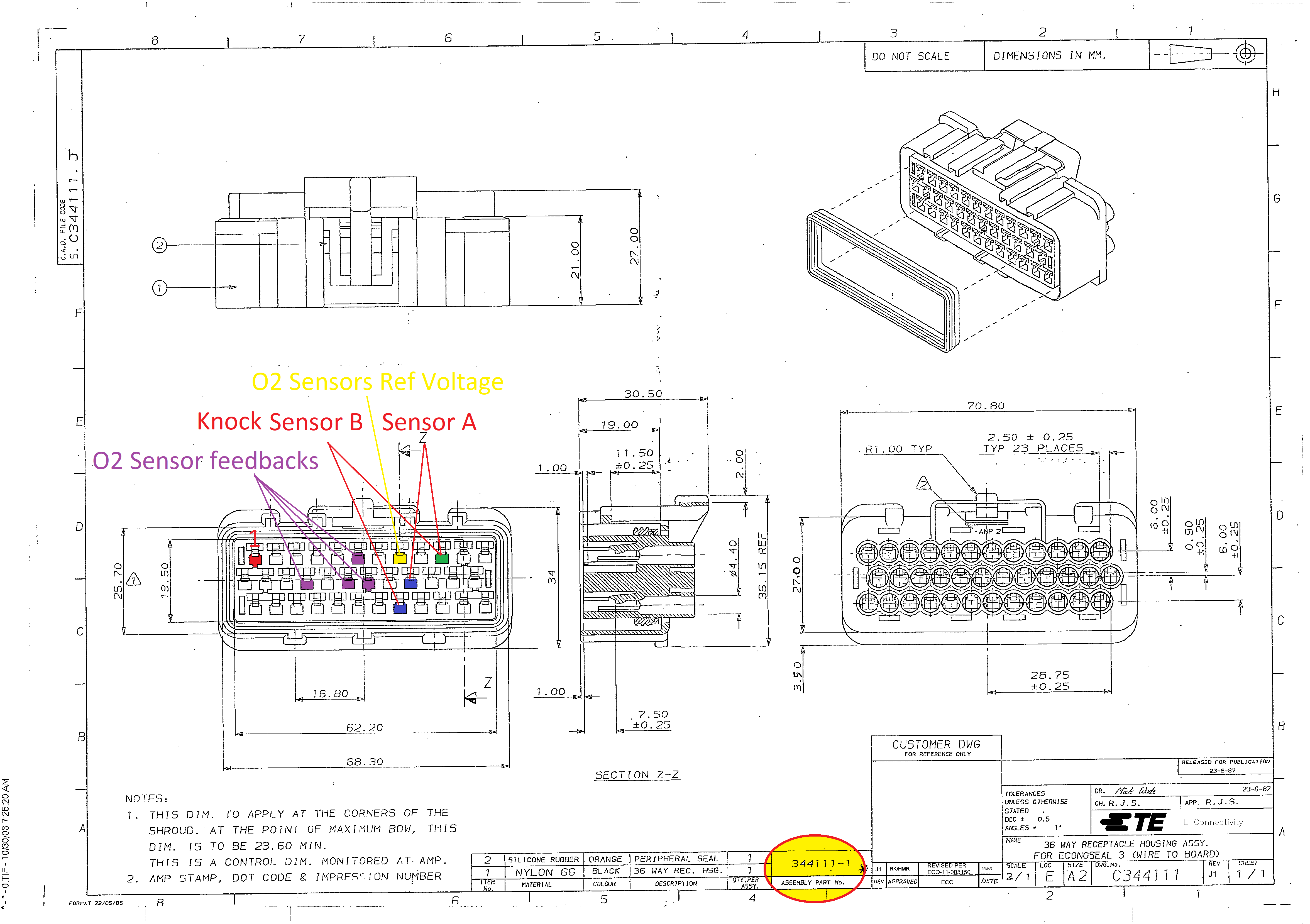

The electrical connector on the transmission will get dirty and effect the idle , especially coming out of park . You have the GM transmission on the S/C engine different then the ZF transmission on the N/A engine so this may not have the same history of a causing this problem . An easy thing to square up without jacking up the car . Besides it's something to keep in good condition like a ground stud . I believe on the ZF transmission that it's a bayonet connector that releases like a air hose coupling and not by twisting .
The Idle Air Control valve may be acting up and might be able to see the command signal with a ELM327
The injectors are ground seeking provided by the ECU . Clean all the engine ground studs including the case ground of the ECU other then the 2 wire ECU grounds
The IAT sensor can be read from the ECU connector without removing it and if possible wiggle the connector to see if you have a problem there . Getting wire positions from wiring guide
Red 1 to Red 30 as 30 is the positive lead on your meter reading resistance comparing to the chart that was provided earlier
The IAT sensor is electronically tied into the camshaft position sensor and the EGR temp sensor so you can remove those sensors connectors and see if they are sucking the signal down . Easier said then done under the S/C intake but I believe the S/C EGR is off to the side .
You can verify the sensor by removing it ( the 2 wire one ) and dipping it in ice water 32 degree and boiling water 212 degree .

How bad are the oscillating revs and are they regular eg in 800-900 range? If its a lot and irregular then I'd look at TPS, if its little and regular I'd look first at o2 sensors orientation(plug them in differently), or even unplug them completely and see whether it happens too(it should run in open loop all the time).
Then a standard coil test, swap one at a time or when it starts to oscillate unplug one at a time see whether oscillating disappears.
You can test the injector signal quite easily with a set on noid lights(they are cheap and widely available). It will be trickier to test the injectors.
Also does the problem appears quickly as soon as it gets to temp and switches to closed mode or later on?
You could also ask the garage to test fuel pressure and have a look at the ECU plug, in case some water got in there(this happens quite often).

Hi Katar83 and company,
To answer your questions
The osciliating revs visibly occur when the car has warmed up and is in idle. It will idle fine for a few seconds, miss a beat fall from 800-900 to 600 and then be fine and then the same thing. If you are reversing and this happens (with foot not overly on acelerator/gas) the car may stall. When driving it is not apparent unless you boot it and then it feels like a flat spot.
The problem appears as soon as car gets to temp and goes into closed loop.
I have asked the garage to look at the ECU plug (this is something I can also check myself)
Thanks for your feedback, any additional thoughts are always appreciated.
Cheers,
Nick

I'm guessing the flat spot is around 3k RPM when you boot it? It does sound like the engine stops firing on one cylinder when this happens, so I'd concentrate on figuring out which one.
Since this happens when it warms up and get into close loop, unplug the o2 sensors, see whether it starts misfiring in a permanent open loop.
I assume you do have a spare coil that you could test, I know you have new ones but I'd still check it just to be sure and yes, have a look at the ECU plug. Its not uncommon for this to fail.
Its probably not that but mine would do this when one of the vacuum ports in the intake was open, without a blanking cap(disappeared one evening). There are two ports, behind the fuel pressure regulator, one should be capped. Might be tricky to see, being the R, but have a look just to be sure.
Checking injectors - I'd leave this to your garage, unless you can get the noid lights.
