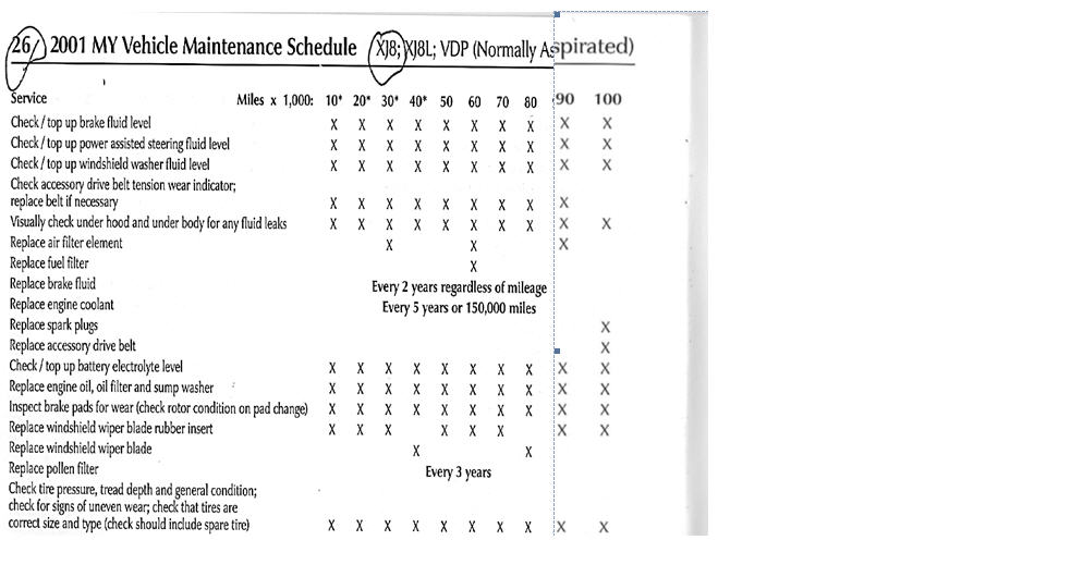

![Default](/forum/images/icons/icon1.gif)
Here is the maintance page in the Vehicle Care manual:
![100,000 mile service on XJ8 what to use?-xj8-vehicle-car-care-maint-schedule.jpg](https://www.jaguarforums.com/forum/attachments/xj-xj8-xjr-x308-27/8691d1480965762t-100-000-mile-service-xj8-what-use-xj8-vehicle-car-care-maint-schedule.jpg)
Parts that I am having changed are:
the Aux Drive Belt, Oil Filter, Motor Oil, Spark Plugs, Air Cleaner Filter, Coolant (flush) and Brake Fluid (flush).

Is this the K&N air filter that has oil in it?
Jim Lombardi

Hi
I did a little browing around this Jag Parts website and their filter prices seem more reasonable than most other places.
Here is a Jpeg file that shows their Filters for XJ8:
![100,000 mile service on XJ8 what to use?-xj8-air-filter-oil-filter-fuel-filter-source.jpg](https://www.jaguarforums.com/forum/attachments/xj-xj8-xjr-x308-27/9618d1480965877t-100-000-mile-service-xj8-what-use-xj8-air-filter-oil-filter-fuel-filter-source.jpg)
I may try them the next time I have to change the filters.
The shipping charges may outweigh the parts cost savings $10.30 for an oil filter and air filter order.
Jim Lombardi
