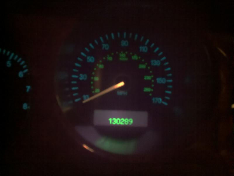

Hey guys, I just recently joined the forums and thought I'd go ahead and start working on my small problems. The first thing is the dim instrument lights. I'm uploading 2 pictures. It randomly goes back and forth between the normal light to the dim ones.

Welcome, my guess would be a faulty brightness adjuster switch. There's a little rotary switch on the side of the steering wheel column that you can adjust the brightness. It may need some attention. Either a weak connection, or mucky contacts within the switch.
To get at it, you'll need to remove the lower part of the steering column shroud. The switch is held in with clips and a screw or two. Check the connections first, if good, pop the switch out and see if you can treat it with electrical contact cleaner. Before buttoning it back up, test it. If it's still acting up, change it.

If you are experiencing the fault during high ambient temps, then it is normal and the INSTPK is protecting itself. Here is a sentence from the Tech Tip from May 2002.
There is a protection function within the cluster that dims the backlighting under conditions of extreme temperature.

Thanks for the help everyone! I'll be getting contact cleaner and checking it tomorrow. I'll report back with the outcome
