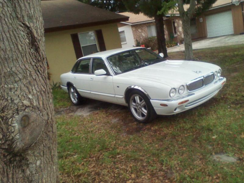

Every time I drive sometimes I hear this weird rattling noise it seems to be coming from the back of my car near the trunk. It's not really loud but definitely noticeable when the radio isn't on too loud. The car has 81k miles, it handles very well and I got the beauty for only $5,500! Any help would be absolutely appreciated since I wanna solve any problems before they get too expensive! Thanks to anyone who helps in my dilemma.

The tires look amazing on the car, there is light wear but nothing that would point out a major suspension problem. I think it may be loose bolt on the strut somewhere.

Also the handling is immaculate.
