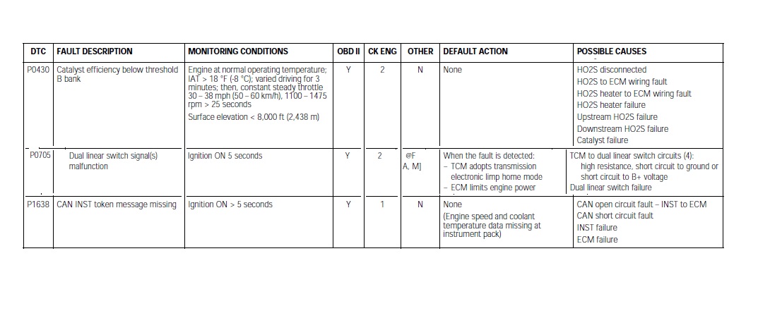

A low or dead battery will throw all kinds of codes on a Jaguar and this is the first thing to eliminate.
You will always get one of the following codes:
P1000 : OnBoard tests not completed since last memory clear
P1111 : OnBoard tests complete
Here's the extract from the Jaguar DTC lists for the others:
![](https://www.jaguarforums.com/forum/attachments/xj-xj8-xjr-x308-27/59323-2001-xjr-codes-p0430-p0705-p1638-help-vincent.jpg?amp;d=1382341669)
See the right hand column for possible causes of each of the codes.
