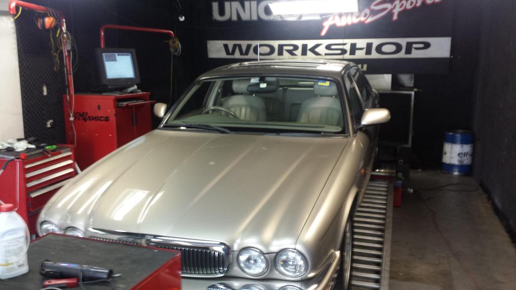

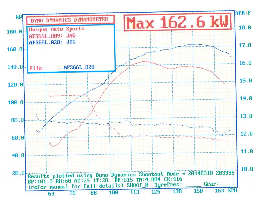

We had spectacular results, improving power and torque using less fuel. We made a few modifications to the air intake, which made the car run leaner and closer to ideal air fuel ratios, being 13 to 1.

So you start with 216.25 KW (290 BHP) and end up with 162.6 KW (218 BHP) ??? I must be getting something wrong here, because the way I am reading this is, that after your modification you end up with 25% roughly, less power than you start with ? Assuming ( and that's always a dangerous thing ) this is rear wheel BHP not flywheel, then how much power does the gearbox ,diff and drive shafts actually rob ? Please don't get me wrong, I am not trying to put you down or demean your work, I am just confused... can you please explain. Thanks in advance, Andy

In answer to Andrews question, the dyno definitely shows power at the rear wheels.
218rwhp is about right for a 16 year old car that supposedly had 290hp at the flywheel from the factory.
Losses of about 20% could be expected through the drivetrain, maybe more, maybe less.

Sounds about right. My XJR was 276kw from quoted figures, but was dyno'd a couple of years back at 240rwkw. You'll always see a lower figure on a dyno than the manufacturer claims

Donb you got it. It is a 4 litre quad cam V8 with 230,000ks, which we have owned for five years. Since we did a major service to it and now tuned it, the motor is so smooth.
As far as AFR's go, turbo cars AFR"s should be around 12 to 1 under load and 13 to 1 for normally aspirated. Most cars from factory run way too rich. We also use Apexi Super AFC's to trim AFR's if the car has an air flow meter.
As far as the power goes, I think it is about right, in fact very good. To compare I had a Lexus LS400 4 litre quad cam V8, which stock standard only made 108rwkw, we added a very quiet high flow exhaust with large straight through custom made mufflers, trimmed AFR's with S AFC, modified intake and it made 150rwkw. The Jag almost made this standard.

Don't know much about rwhp from na cars, but the red curve (original one) isn't a normal one to begin with, there was certainly an issue there which isn't releated to the a/f mixture. Somehow that issue isn't there in the after run (well only very slightly).

Is your XJR modified or standard ? I ask because the difference between the quoted numbers ( 276 KW ) to the rear wheel numbers ( 240 KW ) which I take were taken after the car had a few miles under its wheels is only 13% . If standard I am impressed. Johns car seems to have lost 25% after being modified ? surely the ZF gearbox cant be robbing that much more power than the Merc gearbox ? Because aside from the blower , the drive shafts and diff are identical , even the same ratios ! I understand no two cars will be identical , and there will be a degree of variance between them , but surely not a nearly 50% difference ?

It was also a hub dyno, not a rolling road. I would expect slightly lower readings from a rolling road because of the tyres and momentum etc, but also the dyno I used has been known to read a little high... but that's not really of concern to me, what's more important is that it's consistent, and I could compare with a lot of other cars that have been on the same dyno, and also I can compare if I ever do any mods, as the car is completely stock.
